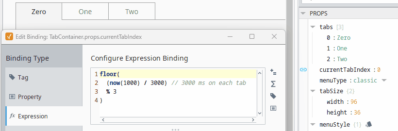

Is there a way to rotate through the tabs automatically?
Like start at 0, wait amount of duration, then goto 1....etc..

**Post date:** [April 12, 2024, 7:58pm UTC](https://forum.inductiveautomation.com/t/autorotate-through-tabs-on-a-tabcontainer/88757/3 "2024-04-12T19:58:06Z")
![Tab auto-index](https://us1.discourse-cdn.com/inductiveautomation/original/3X/a/3/a39ea70f284d15981af8aac7c8ee47e258f9c5af.gif)
Create an Expression Binding on `currentTabIndex`.
```auto
floor(
  (now(1000) / 3000) // 3000 ms on each tab
  % 3 // number of tabs
You may need further code if you want to stop the auto-index.

> [@Transistor](#):
> `// number of tabs`
Nit:
You should be able to use the `len` expression function on `props.tabs`, to avoid hardcoding in the number of tabs.
**Post date:** [April 12, 2024, 8:21pm UTC](https://forum.inductiveautomation.com/t/autorotate-through-tabs-on-a-tabcontainer/88757/7 "2024-04-12T20:21:43Z")
Thanks, Paul!
```auto
// New and improved version!
floor(
  % len({this.props.tabs})
