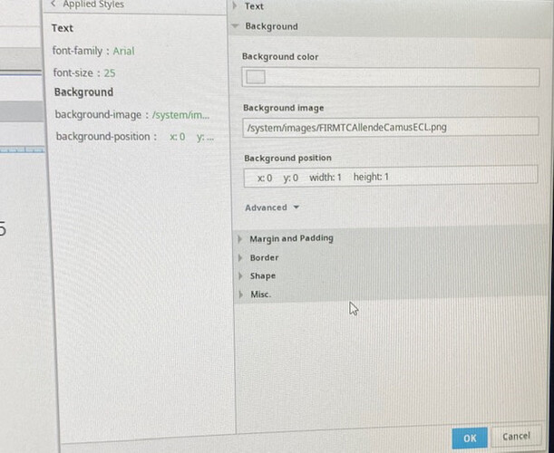

Hello,
i need to fix a background image in a view i added the path of the image in the applied style Background that we can see in the screenshot but it doesnt work can any one know the problem ??
 ![image](https://us1.discourse-cdn.com/inductiveautomation/original/3X/0/f/0fc9a0592f20ebc3e9c3bb08e7445c0d167c048c.jpeg)
thnx ^^

Hello,
You need to wrap it in url (’’)
```auto
url('/system/images/Image/_logo_payoff_2016_blue_300dpi.png')
