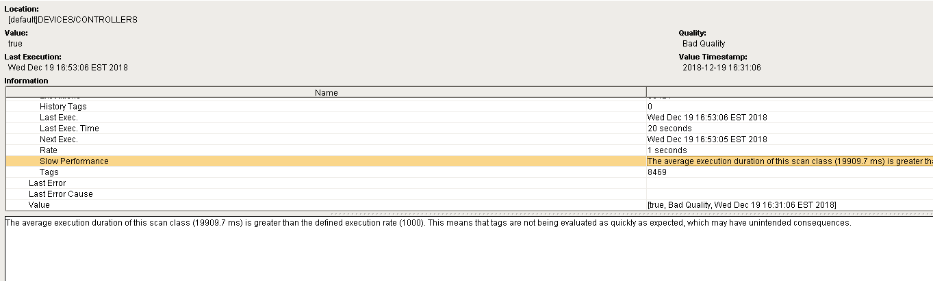

Hi Kevin,
I have AB Compact and Control logix devices,However I get device is Connected tag mostly with bad quality.Even if they are connected.I tried putting them in Slower classes,didn’t help.Tried Increasing the time out didn’t help.Let me know your suggestion.

**Post date:** [December 20, 2018, 8:06pm UTC](https://forum.inductiveautomation.com/t/bad-quality-tags-from-logix-devices/21550/4 "2018-12-20T20:06:08Z")
The first thing you should do is figure out why your scan class execution time is 20s on average. OPC tags do not contribute to execution time unless you’ve set the scan class to OPC Read Mode.
You probably have some slow query or expression tags that you need to find, fix, and/or move to their own scan class.

**Post date:** [December 20, 2018, 8:42pm UTC](https://forum.inductiveautomation.com/t/bad-quality-tags-from-logix-devices/21550/5 "2018-12-20T20:42:42Z")
Hi Kevin,
I understand,we divided the query tags in different scan classes, however during migration,I see all of them being directed to default.My question is even if they are polling slow,then I shouldn’t be seeing bad quality ,correct me if I am wrong.Since I am using same scan class for compact logix driver and they don’t show bad quality
