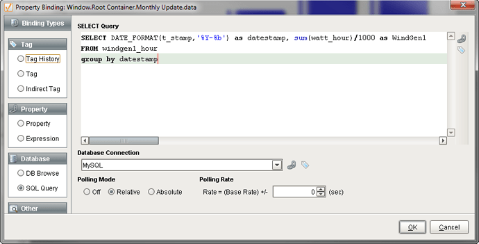

Hello,
How is it possible to change Bar Chart time axis format?
I fill dataset with Postgres query. And I would like to change Bar Chart time axis format. For example if I view Day values, I would like time axis display hours only, not full timestamp. If I view Month values, I would like time axis to display days only and so on. On table i can format column Date Format for example as HH:mm:ss. Is it possible to do such in Bar Chart?
 ![](https://us1.discourse-cdn.com/inductiveautomation/original/2X/b/b5d72138ec3dc2d2f15f95844650a5ecd239a8e1.JPG)
**Post date:** [April 19, 2012, 9:36am UTC](https://forum.inductiveautomation.com/t/bar-chart/4318/2 "2012-04-19T09:36:24Z")
Are you pulling this from a query, then? If so, you can format the x-axis through the query. Here’s a MySQL example:
 ![](https://us1.discourse-cdn.com/inductiveautomation/original/2X/0/007191e224ed4c3e2b768accd0c39e085db60aa8.png)
 ![](https://us1.discourse-cdn.com/inductiveautomation/original/2X/5/5ad360a2e18b3896f66e74b056b63c167f4f35ec.png)

Thank you!
I made what I needed in query through substring by selecting timestamp as string.
