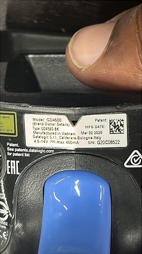

There is no specific pattern, I was looking to scan numbers and alphanumeric values to store to a memory tag.
This is the [datalogic scanner](https://download.delfi.com/SupportDL/Datalogic/Handheld%20scanners/GM4500/Manual/gryphon_I_gd-gm-gbt_4500_prg_eng.pdf) we have, I don't know how it was set up

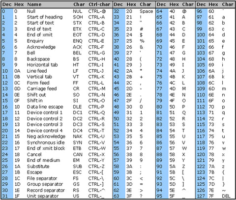

Control codes are all in the first column.
 ![Standard-ASCII-Table_large](https://us1.discourse-cdn.com/inductiveautomation/original/3X/3/5/357e6472e4edeed0e9bffad9fb39274e1ee48de3.jpeg)
_ASCII table. Image source: [commfront.com](https://www.commfront.com/pages/ascii-chart)._
STX and ETX look like good choices.

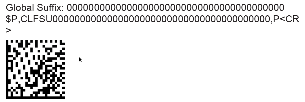

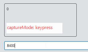

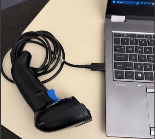

`BarcodeScannerInput` is not working right at all.
I tried adding a Input `TextField` in perspective and It is matching the scan. for example `8400` in the Text field shows as `8400` however the same scan in `BarcodeScannerInput` object for a brief moment is flashes as` 8400 vertically like`
```python
8
4
0
0
and only 0 stays. Same behavior after changing the captureMode and Regex = (.\*)
 ![image](https://us1.discourse-cdn.com/inductiveautomation/original/3X/9/2/92b0630db288a3a3805dd3db731c8ce77b46e28a.png)
The regex setting that @VinceV gave does not work after removing the Return carriage behavior by scanning the scancode given by the Datalogic support team to capture .
 ![image](https://us1.discourse-cdn.com/inductiveautomation/original/3X/a/f/af9c97dcb48bb50b36bfae34ed84ef5fce59ae6e.png)
In both `Regex` setting it is capturing all the keys from the keyboard of the laptop as well.
Here is my setup
 ![image](https://us1.discourse-cdn.com/inductiveautomation/original/3X/5/9/596a5c3785d435c165fe9531c5f67d060ab21c62.jpeg)
**Post date:** [June 18, 2025, 10:39pm UTC](https://forum.inductiveautomation.com/t/barcode-scanner-input-data-n-d-enter/107436/15 "2025-06-18T22:39:06Z")
Your behavior is as expected since you lack a distinct prefix and suffix. You **must** reconfigure your scanner.
