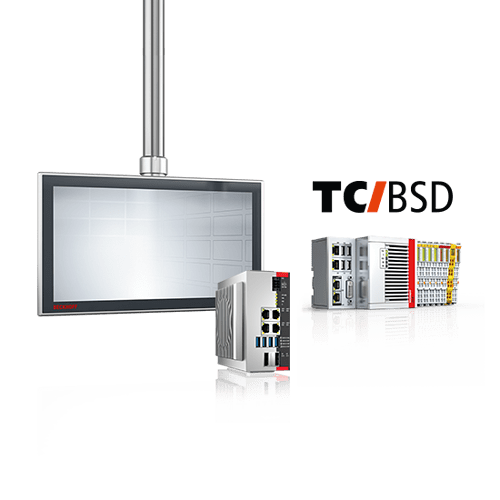

**Post date:** [January 5, 2022, 5:18pm UTC](https://forum.inductiveautomation.com/t/beckhoff-ads-driver/54652/13 "2022-01-05T17:18:20Z")
Since few years, the PLC Runtime can use **FreeBSD** instead of Windows 😉
I’ve never used this flavour of TwinCAT.
For me the big drawback of this kind of PLC for critical process, is the lack of a redundant CPU version.
> **[TwinCAT/BSD: operating system for Industrial PCs](https://www.beckhoff.com/fr-fr/products/news/twincat-bsd/)**
> TwinCAT/BSD for all Beckhoff Industrial PC platforms combines the TwinCAT runtime with FreeBSD, an industrially tested open source operating system.
