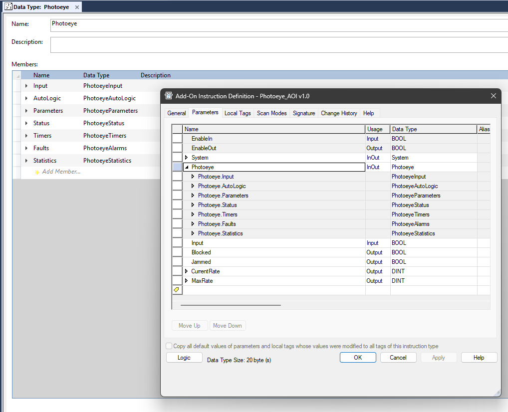

In short, we use UDTs in our PLC code and we use those UDTs as InOut parameters for corresponding AOIs that handle all the logic. We instantiate the AOIs, but don’t use the AOI tag instances anywhere. All logic and HMI statuses refer to the UDT. Below is out Photoeye UDT structure as well as the AOI definition.

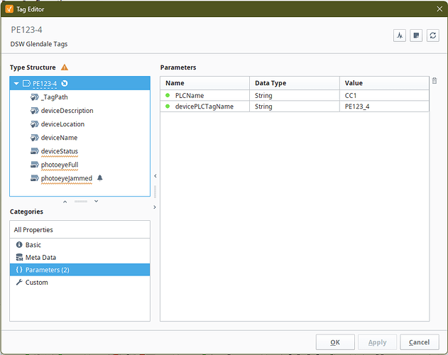

Right now, I have an Ignition UDT made which takes in the “PLCName” and “PLCTagName” as parameters as so:
 ![image](https://us1.discourse-cdn.com/inductiveautomation/original/3X/6/8/682940287112a125b56018031dca38e6bcb346c2.png)
and builds OPC paths using those to reference specific tags as so:
 ![image](https://us1.discourse-cdn.com/inductiveautomation/original/3X/3/f/3ffef9024a9cd0baf879030e6798cf882fd46a92.png)
I’m grabbing values from different members from all over the UDT (for example, I’m pulling the Jammed value from PEXXXX.Faults.Jammed but pulling the Photoeye status from PEXXXX.Status.HMI and the Jam Time Preset from PEXXXX.Parameters.JamTimePreset). I understand it would be way more efficient to group these all in a .HMI member structure in the Photoeye UDT, but my problem is I have certain tags (primarily manual run/jog controls for things like motors) that I’d like to have a very quick poll rate so the HMI doesn’t feel slow to respond when manually controlling devices. But I don’t want to overload the comms by making everything a super quick poll rate. On-screen statuses like conveyor running status doesn’t have to update quite as quick and things like device descriptions that I pull from the UDT and display on popups can have really slow poll rates because they won’t be changing often if ever.
Am I better off clumping everything together in the UDT in a single HMI member structure and having it update super quick because it’ll pull it all at once and be plenty efficient? Or would making separate HMI member structures based on update rate be better? Within the HMI member, I’d imagine I’d just have a relatively small array of each data type I need (bool[10], dint[10], float[5], string[5]) and I’d just map different things to each one based on the main UDT type. Either of these methods I believe would be better than how I have it, but is it enough? Or do I need to go so far as to make arrays of HMI structures for each poll rate and correlate members of those arrays to each existing device (e.g. PE123\_4 would correspond to HMI[1]). This would require making the HMI tag instance an InOut parameter of my device AOI or making a new AOI for each device type to map the statuses to the HMI instance. This would also require correlation in Ignition as well. I’d rather not have to know to add HMI[1] as the PLCTagName parameter for PE123-4 instead of just PE123\_4. That all just seems overcomplicated, but I have no idea if it’s necessary or totally overkill (even for a larger system). I haven’t had a chance yet to toy with one method vs another, but I figured I’d ask the question to hopefully get pushed in the correct path. Thanks in advance for any and all help!
