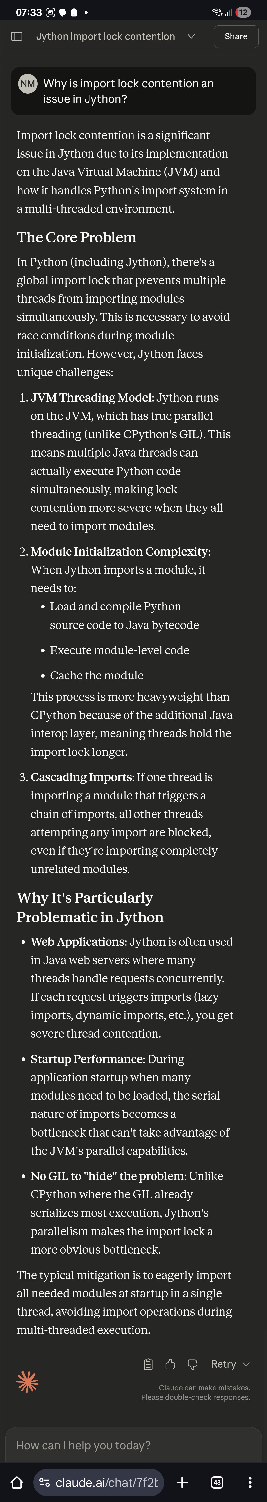

**Post date:** [November 6, 2025, 7:38pm UTC](https://forum.inductiveautomation.com/t/best-practice-for-handling-db-writes-for-multiple-udt-tag-events-safely/111996/4 "2025-11-06T19:38:40Z")
> [@RodrigoR](#):
> `from com.inductiveautomation.ignition.common.tags.paths.parser import TagPathParser`
Surprised you didn’t mention the import within an event script, @pturmel
I Clauded that one
 ![Screenshot_20251106_073325_Chrome](https://us1.discourse-cdn.com/inductiveautomation/original/3X/3/2/3293e950b3bd37c0bede00698201cc80120b165d.jpeg)
