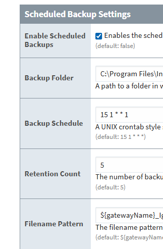

**Author:** ![Alejandro\_Alaco](https://sea1.discourse-cdn.com/inductiveautomation/user_avatar/forum.inductiveautomation.com/alejandro_alaco/32/59849_2.png) [@Alejandro\_Alaco](https://forum.inductiveautomation.com/u/Alejandro_Alaco)\
**Post date:** [July 17, 2025, 7:31pm UTC](https://forum.inductiveautomation.com/t/best-practices-for-managing-gateway-backup-versions-across-environments/108640/2 "2025-07-17T19:31:25Z")
You may know already, this can help with you backup.
Gateway can backup itself with sheduled backup settings.
 ![image](https://us1.discourse-cdn.com/inductiveautomation/original/3X/a/3/a3133f30d5b41aac72fa197bfdeec5a881cd2cc1.png)
 ![image](https://us1.discourse-cdn.com/inductiveautomation/original/3X/7/e/7eb0e9b9ec3eabc021fc1adcff17d07cc6f94c1b.png)
I do automatic backups of my gateway every week. Your needs may be others.
Cheers.

On each of our servers that host a gateway we mount a remote network drive that we save to similar to how @Alejandro_Alaco mentioned.
So each gateway gets saved to
`/<remoteBackupServer>/<gatewayName>/<${gatewayName}_Ignition-backup-${edition}${timestamp}.gwbk>`
so if you had 2 different gateways both saving to the same remoteNetwork drive it would look like
/remote-server/gateway-1/
and
/remote-server/gateway-2/
This seems to be the most manageable because all your backups are in one central location but they're still in separate folders so it's easy to sort through them once you get a bunch of gateways =D
