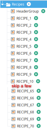

I have a lot of tags, nearly 42,000 that I would like to clear the value of before writing to them. These are memory tags with a mix of Integer, Boolean, String, and Float datatypes. Before I explain why let me lay out the design.
**Note** : I will probably end up mixing terms trying to explain without divulging any protected information. I am in the testing phase so these tags aren’t being written to the PLC, yet.
These tags make up the “recipe system”. I have block transactions set up to pull recipes from our SQL database to these tags.
 ![image](https://us1.discourse-cdn.com/inductiveautomation/original/3X/0/8/08d9aea8754ef7a9cc06e873a3b61d52de3debf1.png)

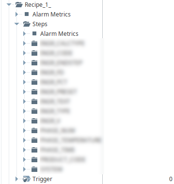

```python
Recipe_#
There are 70 Recipes Recipe_1_ to Recipe_70_ each one has 14 folders with Tag 1..99
 ![image](https://us1.discourse-cdn.com/inductiveautomation/original/3X/b/3/b3bc280f5e23ed2064f1e51ac843bac6182c3e74.png)
 ![image](https://us1.discourse-cdn.com/inductiveautomation/original/3X/d/6/d6e2ccb2c73ae89569599ba7353b4ff7c96d4199.png)
These are used in SQL-Bridge block transactions. There are triggers used to cascade from one block to the next. That works fine to write the tags that have records in the SQL database. It takes some time but that’s not a concern. My current solution is an Excel spreadsheet that uses VBA and RSLINX to write the values.
The header structure holds some basic data about the recipe. Each Recipe\_# folder holds up to 99 steps for the recipe. However, not all 99 steps are used and the database only contains the records for defined steps. I.E. there aren’t blank placeholder records. Recipes can change from time to time and steps may be changed, removed, added.
If a recipe is changed and steps are removed the previous values don’t get cleared when the block transactions are performed.
```plaintext
Let's say Recipe 42 has 23 steps. A change come down and the recipe now only has 18 steps. The transaction will overwrite steps 1-18 but the tag values for 19-23 are not overwritten/cleared/erased/set to default as there is no record in the database for those steps.
They just don’t get written. I don’t see a way to have the block transaction “write default value if no record returned”. This functionality appears to be different than the options:
`Set NULL tags values to default `
`set NULL DB values to default`
as these appear to only perform their action if a record is returned with NULL values.
Due to the design by others previous to me there is no ‘end step’ defined for a recipe 🥵 , the PLC just goes till it runs out of commands. This would mean the PLC would attempt to run steps 19-23 as there would be data.
My goal is to allow a “user” in Ignition to perform this entire procedure via 1 button if I’m not available. Ignition will also have the ability to view each recipe which will be new to them.

Have you tested this with “set NULL DB values to default” turned on? I’m fairly certain that I tested this for a project and it did clear the values that had no results in the database.
**Author:** ![dis](https://avatars.discourse-cdn.com/v4/letter/d/e99b99/32.png) [@dis](https://forum.inductiveautomation.com/u/dis)\
**Post date:** [September 30, 2025, 5:23pm UTC](https://forum.inductiveautomation.com/t/best-way-to-clear-the-value-for-42-000-tags/111104/4 "2025-09-30T17:23:58Z")
> [@robertm](#):
> But instead of all 42000 tags, why wouldn’t the operator just clear out the one recipe that’s changed?
edit: The operator may not know as if a recipe was removed then currently everything would “shift up”. I’m working through attempting to standardize this whole setup as there isn’t much structure or planning. A long time ago this was an Access “database” then was upgraded via copy/paste to SQL.
> [@Clancy\_Cavanaugh](#):
I swear that didn’t work the first time. It appears that perhaps there was a delay in the update on the tag browser?
