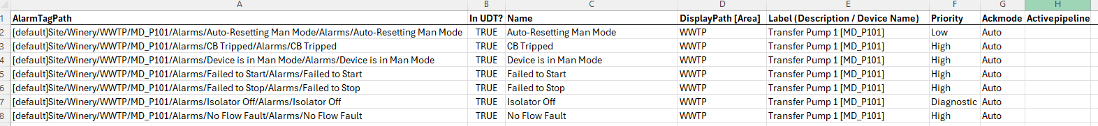

Note: simply using system.tag.query will return the alarms object for each tag and won't give you a nice CSV of all alarms you can use.
I use this script to retrieve all alarms and given prop values given a baseTagPath. It will also tell you if the tag is part of a UDT or not:
```python
Get the details of all alarms configured from a tag path and return a table to the clipboard.
Note: Uses system.tag.query to retrieve the list of tag paths along with their list of alarms. The values are read from the tags themselves
IMPORTANT NOTE:
It's highly recommended that the base tag path folder be "restarted" in the tag browser (right click on folder > "Restart Tag") before running this so that all tag prop bindings are up-to-date and are evaluated if they haven't been evaluated previously. Otherwise you may see nulls in these prop values.

It will produce something like this:

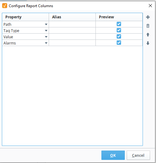

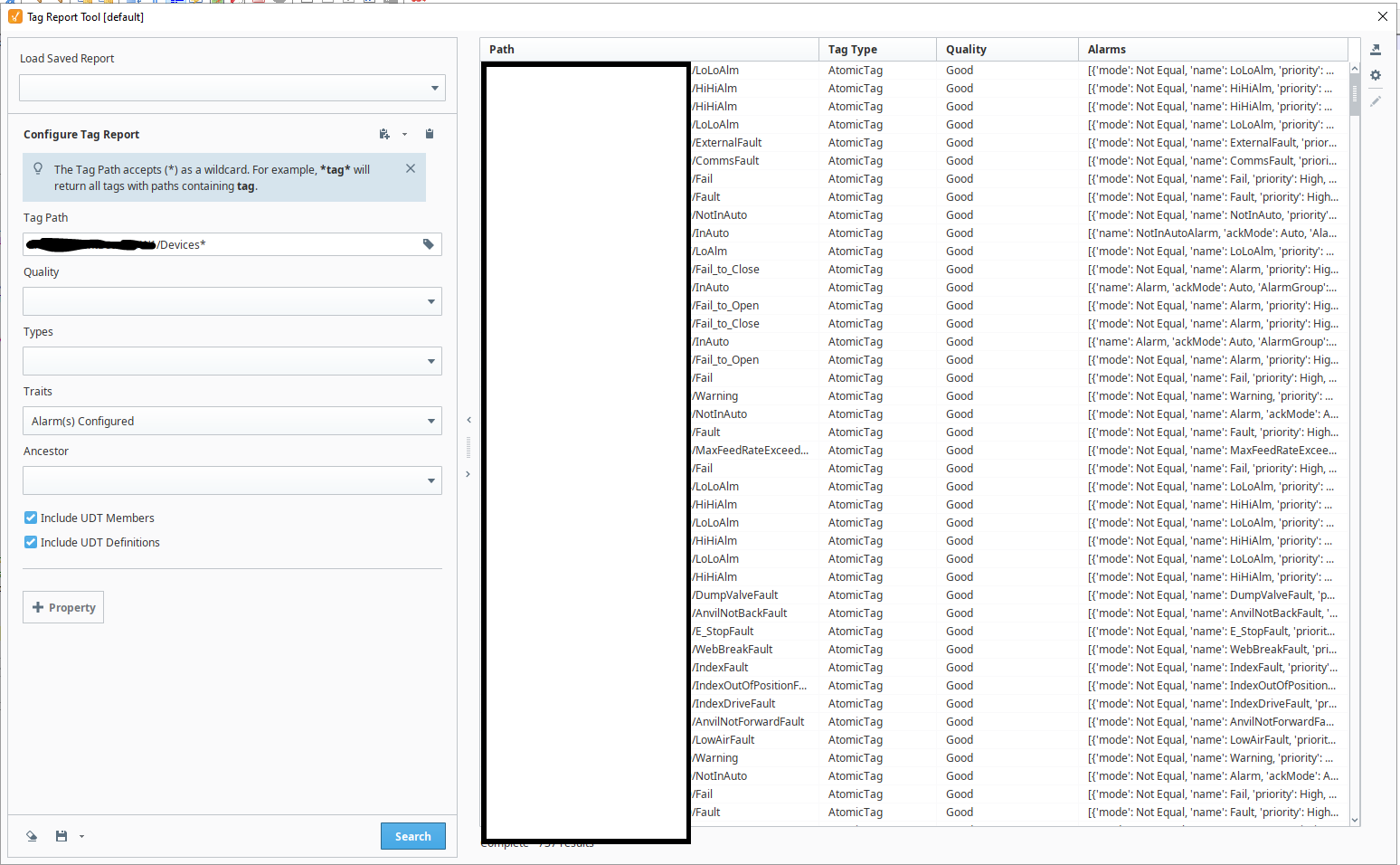

**Post date:** [July 10, 2025, 2:55pm UTC](https://forum.inductiveautomation.com/t/best-way-to-generate-an-alarm-list/11773/15 "2025-07-10T14:55:13Z")
I would be fine doing it manually using the tag report tool. But while it seems to grab all the alarms, I can't find a single viewable property that gives the alarm name. "Name" is empty.

**Post date:** [July 10, 2025, 3:33pm UTC](https://forum.inductiveautomation.com/t/best-way-to-generate-an-alarm-list/11773/17 "2025-07-10T15:33:13Z")
Ill try this, but the tag report tool itself didnt seem to give the alarm name under any report option, which is the most important property to capture. The property "name" returned the tagname suffix for all tags with alarms, but not individual alarms configured. Also, no method appears to delineate tags with more than one alarm configured to its value, like a high and low alarm.
**Author:** ![MMaynard](https://sea1.discourse-cdn.com/inductiveautomation/user_avatar/forum.inductiveautomation.com/mmaynard/32/3366_2.png) [@MMaynard](https://forum.inductiveautomation.com/u/MMaynard)\
**Post date:** [July 10, 2025, 4:24pm UTC](https://forum.inductiveautomation.com/t/best-way-to-generate-an-alarm-list/11773/18 "2025-07-10T16:24:25Z")
you can configure the returned table by clicking the gear top right.
Add a row, select alarms and check preview.
Then rerun the search.
It returns all of the configured alarms and the parameters for them.
 ![image](https://us1.discourse-cdn.com/inductiveautomation/original/3X/7/7/77f20daae8313a05349fe216b582fa690637e66b.png)
 ![AlmTags](https://us1.discourse-cdn.com/inductiveautomation/original/3X/4/4/44516c7469b47f7c16d8bdc6b537f7d3802a7df9.png)

Interesting...this script gives the alarm description that I need. Wonder why the tag report tool console does not, if the engine is the same.
**Post date:** [July 10, 2025, 4:35pm UTC](https://forum.inductiveautomation.com/t/best-way-to-generate-an-alarm-list/11773/20 "2025-07-10T16:35:59Z")
Yes, I know, but none of those available properties gives the ALARM name.
Your tag query example returns the proper verbage under "name". The tag query tool only returns the tag's last path delimeter under "name".
Example:
Path = "HMI\_Bits\_3/2
Alarm Name = "CP-64-1101 loss of power"
Tag tool returns "2" as the name
Query returns "CP-64-1101 loss of power"
Edit...ah, I do see them under "Alarms", not names, as part of an extended data return. Not ideal, but useable. Thanks!!
