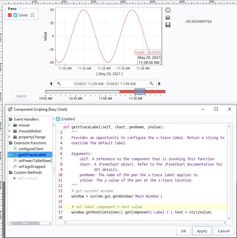

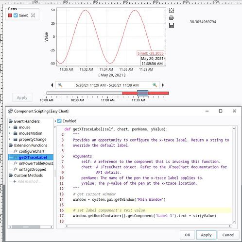

The **‘yValue’** property within the **‘getXTraceLabel’** extension function will return it. Here is an example where I write it to a label component within the same window.
 ![2021-05-20 12_45_58-Window](https://us1.discourse-cdn.com/inductiveautomation/original/3X/c/9/c95fa37be49a797c857b716ea89b798b0189b366.jpeg)
