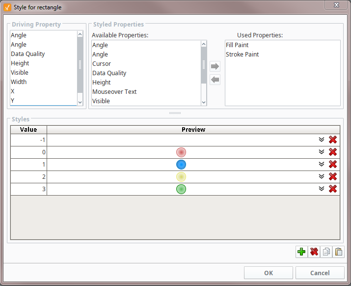

Is there any way to bind a gradient fill paint? or to set a components fill to gradient through scripting?
tried a few things and read the user manual but couldn’t get it to work.
Cheers
Ivan

Not right now. We are working on creating new expressions to make gradient fills.

**Author:** ![witman](https://avatars.discourse-cdn.com/v4/letter/w/d2c977/32.png) [@witman](https://forum.inductiveautomation.com/u/witman)\
**Post date:** [February 11, 2020, 6:09pm UTC](https://forum.inductiveautomation.com/t/binding-gradient-fill-paint/4648/5 "2020-02-11T18:09:36Z")
This is possible–though awkward–with the style customizer:
 ![image](https://us1.discourse-cdn.com/inductiveautomation/original/2X/e/e88a57d4318a297a5049e443579db1947fabe65e.png)
The trick is you can’t set these fills in the style customizer, but it will show the fill you already have when you open the style customizer. Set the fill you want directly on the object, open the style customizer, and it will be there. Repeat and adjust the values for each style until you have all the gradient fill styles you need.
