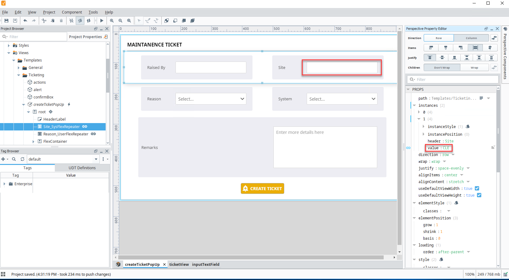

I have a Flex Repeater with a template containing a label and a text field. I want to automatically populate the text in the Text Field by default when the view is opened. In the picture below, I have created a binding for the value of the Text Field in the Flex Repeater component but this isn't working.
Any thoughts?
 ![image](https://us1.discourse-cdn.com/inductiveautomation/original/3X/c/a/ca6da89b77aab5bfcaef4a5aa714027355f30215.png)
**Post date:** [June 16, 2023, 8:56pm UTC](https://forum.inductiveautomation.com/t/binding-to-text-field-in-a-specific-instance-of-a-flex-repeater/75172/2 "2023-06-16T20:56:51Z")
Is that text component's `text` property correctly bound to its view's `value` property?
**Author:** ![cmallonee](https://sea1.discourse-cdn.com/inductiveautomation/user_avatar/forum.inductiveautomation.com/cmallonee/32/6416_2.png) [@cmallonee](https://forum.inductiveautomation.com/u/cmallonee)\
**Post date:** [June 17, 2023, 7:29pm UTC](https://forum.inductiveautomation.com/t/binding-to-text-field-in-a-specific-instance-of-a-flex-repeater/75172/3 "2023-06-17T19:29:03Z")
Make sure the `text` property of the Text Field in that instanced view is bound to `view.params.value`.
