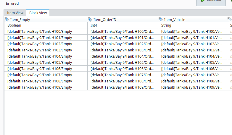

I need to use a Block Transaction Group to pull information on multiple tanks from a database table into their corresponding Ignition tags.
In the block view, the items are in alphabetical order based on the tank’s name. The tanks are named “H100,” “H101,” etc.
 ![image](https://us1.discourse-cdn.com/inductiveautomation/original/2X/b/b49611d88a6d32d34f3da26c9ae9dc580bd29bb4.png)
In order to ensure that my SELECT query pulls in the rows sorted by name, i must make “name” as the custom index column. However, Ignition is not happy when this custom index is non-numeric. I get an error that “H100” cannot be cast as a BIGINT.
I can make my custom index the primary key in my table, but then the sorting is incorrect: Ignition will return rows sorted by the primary key, causing a mismatch between the tanks. Tank H100 will receive H107’s data, because H107 has a lower primary key value.
Is there a way that I can: convince Ignition that having a custom index that is alphanumeric is acceptable OR sort my SELECT query based on a column other than the custom index?

So far my only workaround is to use the “--” SQL inline comment. So my WHERE clause in my block group reads (sloc is what we use for the tank name):
```auto
sLoc = '{[~]Tanks/Bay 9/Tank H100/sLoc}' OR
sLoc = '{[~]Tanks/Bay 9/Tank H101/sLoc}' OR
sLoc = '{[~]Tanks/Bay 9/Tank H102/sLoc}' OR
sLoc = '{[~]Tanks/Bay 9/Tank H103/sLoc}' OR
sLoc = '{[~]Tanks/Bay 9/Tank H104/sLoc}' OR
sLoc = '{[~]Tanks/Bay 9/Tank H105/sLoc}' OR
sLoc = '{[~]Tanks/Bay 9/Tank H106/sLoc}' OR
sLoc = '{[~]Tanks/Bay 9/Tank H107/sLoc}' OR
sLoc = '{[~]Tanks/Bay 9/Tank H108/sLoc}' OR
sLoc = '{[~]Tanks/Bay 9/Tank H109/sLoc}'
ORDER BY "sLoc" ASC --
