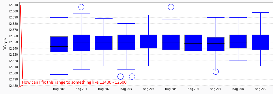

I have multiple Box and Whiskers charts that I would like to compare, but the Axis is Auto-Ranged so it varies slightly for each chart. Is there a way to fix the Range so that they can be compared easily?
Thanks,

```auto
chartComponent = event.source.parent.getComponent('Box and Whisker Chart')
chart = chartComponent.getChart()
plot = chart.getPlot()
axis = plot.getRangeAxis()
axis.setRange(12400,12600)
**Author:** ![DavidWisely](https://sea1.discourse-cdn.com/inductiveautomation/user_avatar/forum.inductiveautomation.com/davidwisely/32/10482_2.png) [@DavidWisely](https://forum.inductiveautomation.com/u/DavidWisely)\
**Post date:** [June 11, 2019, 9:27pm UTC](https://forum.inductiveautomation.com/t/box-and-whiskers-chart-axis-range/25707/3 "2019-06-11T21:27:56Z")
Great! Works perfectly.
Thanks jpark
