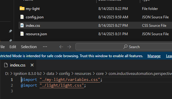

**Author:** ![nader.chinichian](https://sea1.discourse-cdn.com/inductiveautomation/user_avatar/forum.inductiveautomation.com/nader.chinichian/32/9261_2.png) [@nader.chinichian](https://forum.inductiveautomation.com/u/nader.chinichian)\
**Post date:** [August 14, 2025, 4:51pm UTC](https://forum.inductiveautomation.com/t/bring-back-direct-css-editing-in-perspective-keep-dev-workflows-fast-transparent/109627/13 "2025-08-14T16:51:37Z")
Ok, I wonder when I only add `index.css` into to the resource file and inside index.css we have `@import "./variables.css"; ` it should automatically access to it without adding to the resources. Am I right? The index.css is entry point to whole other nested CSS files. In practice, we have +50 CSS file, now imagine it will be nightmare for me to add all of these dependency into the resource file.
Imagine I add all of my css file inside another folder called my-light and I just reference variables.css from index.css as following image. This doesn’t work.
 ![image](https://us1.discourse-cdn.com/inductiveautomation/original/3X/2/a/2a59d6ef6cc54366dc41f23af95984b4688be464.png)
