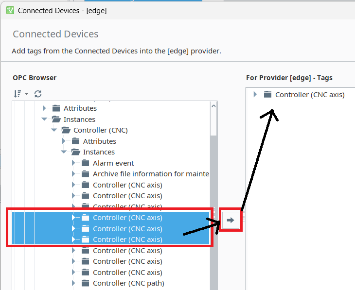

_Prerequisite_: OPC UA server with duplicate folder display names but unique path ID’s
_Problem_: Connected Devices Tag Import ignores folders with duplicate names when adding tags into the provider
_Expectation_: The structure in the OPC Browser pane persists in the Provider pane when added using the ‘add’ arrow button

 ![image](https://us1.discourse-cdn.com/inductiveautomation/original/3X/5/c/5caa7692ae5203de25e0238d63cd21f77508776b.png)

Ignition tags must be uniquely identified by their folder path. There's no way to get around that requirement - you _must_ come up with different names in Ignition within a given folder (including the root of a tag provider).

If you drag and drop from the old OPC Browser (View \> Panels \> OPC Browser, I think) it might create unique tag paths for you by appending \_1 etc…

My thanks. This was successful, the duplicate folder display names were automatically suffixed with ‘ 1’, ‘ 2’, … For my purposes this will work perfectly and save a tremendous amount of time.
