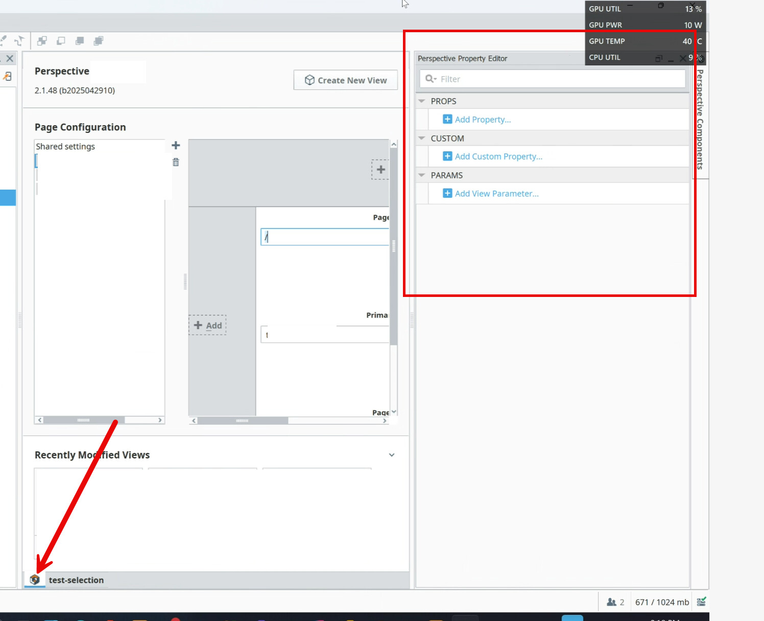

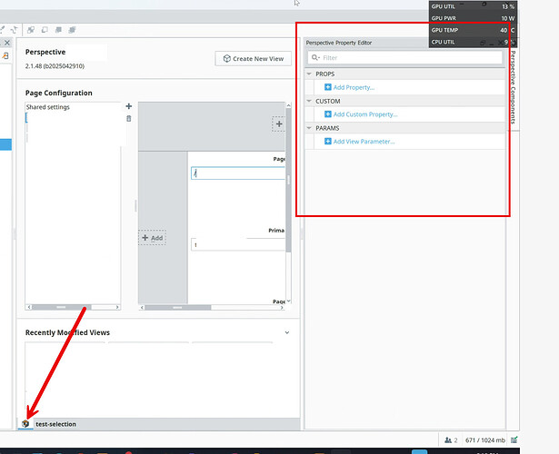

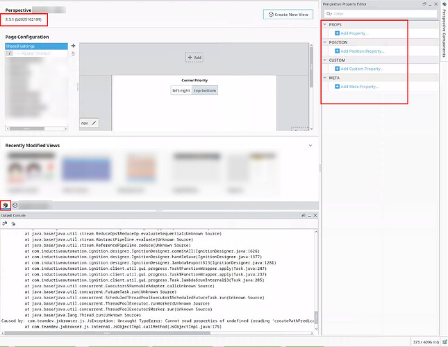

Hi @cconnor ,
I'm encountering the same issue again. In the Designer session, the session custom properties are visible under the "Custom" section.
However, when I try to bind a component to one of these custom session properties, they are not available for selection in the binding dialog.
 ![image](https://us1.discourse-cdn.com/inductiveautomation/original/3X/1/c/1c6e68d99ce84faeabbf518b93e8bf9dbea3466c.png)
 ![image](https://us1.discourse-cdn.com/inductiveautomation/original/3X/6/f/6fd16022bf48793550496cd3e95d1646c88439c8.png)
Additionally, in the `props.json` file, the `custom` section appears empty:
 ![image](https://us1.discourse-cdn.com/inductiveautomation/original/3X/7/5/75b4cb36992ba15bed8defc1f6ecbca25767af90.png)

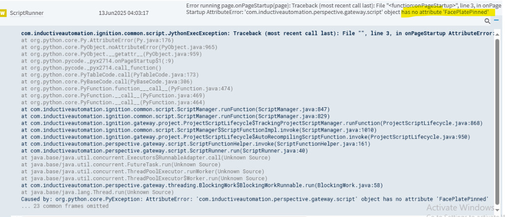

When I try to access these custom session properties in a script, I get an error stating that the attribute does not exist. This indicates that the session custom properties are not being recognized or persisted correctly at runtime.
 ![image](https://us1.discourse-cdn.com/inductiveautomation/original/3X/0/3/03f3d7bf0f827b4a6462999360f76cb3e58469ab.jpeg)

**Author:** ![cconnor](https://sea1.discourse-cdn.com/inductiveautomation/user_avatar/forum.inductiveautomation.com/cconnor/32/33235_2.png) [@cconnor](https://forum.inductiveautomation.com/u/cconnor)\
**Post date:** [June 13, 2025, 5:01pm UTC](https://forum.inductiveautomation.com/t/bug-10710-session-custom-properties-dissapearing/21553/29 "2025-06-13T17:01:36Z")
Hi @HAKEEM_DAYARAJU,
Are there any errors in the Designer output console when you notice the issue? What about when you save the project after the issue occurs? Are you able to add a new session custom prop and save the project without issue?
I would like to work with you (and anyone else here) more closely. At this time we do not have replication steps and will need to dive deeper on a system experiencing the issue to understand the cause. I encourage anyone here to reach out to support so we can work together to resolve this issue. Link this forum post so the intake rep knows to connect us.

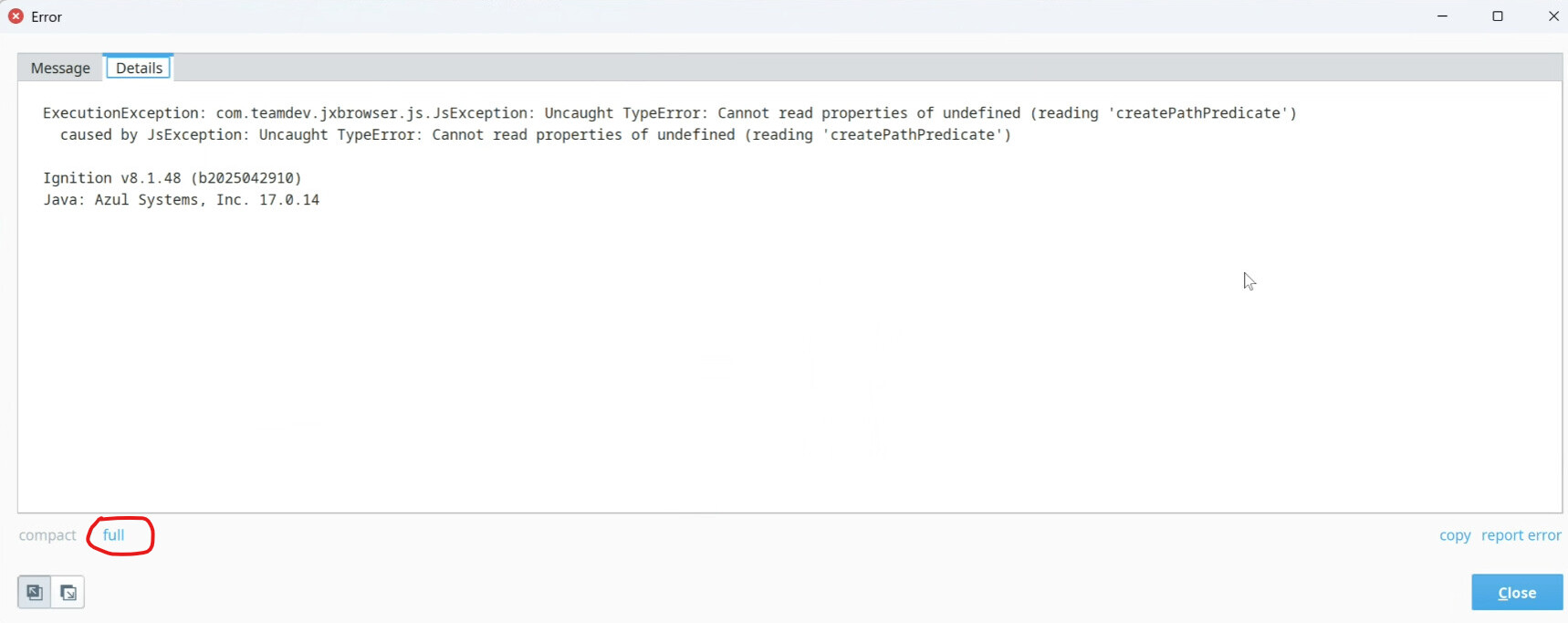

I have had the session properties disappear in .48 when there were no designers open.
Yesterday I saw the following
 ![image](https://us1.discourse-cdn.com/inductiveautomation/original/3X/2/c/2c937369e9ba398e49669b9853953de97b60ec79.jpeg)
 ![image](https://us1.discourse-cdn.com/inductiveautomation/original/3X/2/9/29311c9eaea547c7184885af0e9bc8c7d24c7f04.jpeg)
**Post date:** [June 13, 2025, 5:17pm UTC](https://forum.inductiveautomation.com/t/bug-10710-session-custom-properties-dissapearing/21553/32 "2025-06-13T17:17:27Z")
Hi @jpark,
Thanks for reaching out! Did this ExecutionException error pop up when you first opened the Designer?
Is there any more information provided or a stack trace if you select 'full' at the bottom of the error popup?
 ![image](https://us1.discourse-cdn.com/inductiveautomation/original/3X/e/4/e46adb23e9d19e4762cd6316876cd4b97aff007a.jpeg)
Were you able to recover your session props by closing and reopening the Designer?

**Author:** ![HAKEEM\_DAYARAJU](https://sea1.discourse-cdn.com/inductiveautomation/user_avatar/forum.inductiveautomation.com/hakeem_dayaraju/32/76842_2.png) [@HAKEEM\_DAYARAJU](https://forum.inductiveautomation.com/u/HAKEEM_DAYARAJU)\
**Post date:** [June 16, 2025, 5:26am UTC](https://forum.inductiveautomation.com/t/bug-10710-session-custom-properties-dissapearing/21553/34 "2025-06-16T05:26:40Z")
Hi @cconnor ,
these are the errors in Designer console, duplicated the session custom properties & tried to check them, the same issue occurred — **the gateway status logs indicated that the object had no such attribute or property name**. I then restarted the Designer, and I noticed that the session custom properties were missing. I recreated them with the same names, saved the changes, and everything started working fine. However, I’m not sure why this issue happened or when it might happen again. For information, only a **single Designer & project** was open at the time.
 ![image](https://us1.discourse-cdn.com/inductiveautomation/original/3X/3/3/33f433fb2a12676b1da66b81f6a3abe09b802aef.png)
 ![image](https://us1.discourse-cdn.com/inductiveautomation/original/3X/e/8/e88a3b13de020da67afc67a33b8d112e887791ee.png)

I have just noticed that this has occurred on a 8.1.39 to 8.3.0 upgrade.
It seems that all of the Session Properties have disappeared completely… Only information from the console we are seeing is below, which gives very little information on what has actually occurred.
```python
10:53:36.719 [Browser Thread: 1093a521-6eb4-4323-8e09-cf9c068bebf4] INFO Perspective.SessionProps -- Exception translating text Rows per page TypeError: Cannot read properties of undefined (reading 'page')

**Author:** ![Steve\_Booth](https://sea1.discourse-cdn.com/inductiveautomation/user_avatar/forum.inductiveautomation.com/steve_booth/32/82019_2.png) [@Steve\_Booth](https://forum.inductiveautomation.com/u/Steve_Booth)\
**Post date:** [December 10, 2025, 5:32am UTC](https://forum.inductiveautomation.com/t/bug-10710-session-custom-properties-dissapearing/21553/37 "2025-12-10T05:32:09Z")

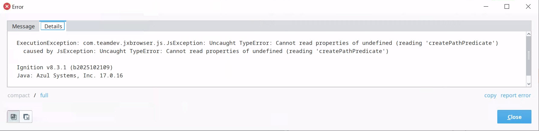

This just happenned in our v8.3.1 build. I noticed it after hitting the ‘Save’ button. Just prior to saving I had been working on binding a query to the props.series[0].data property of a Time Series Chart (line) component. The binding works, so not sure if it was related to the dissaperance of the Session Props.
I didn’t have anything in particular stored in the session-props other than the timezone, but I do refer to the session id in some scripts.
I restored from a recent backup as a new name and the session props were good. Interestingly, I then opened the ‘corrupt’ project and the session props had magically reappeared so I didn’t have to update any recent changes in the end.
All good again, but thought I should share.
 ![2025-12-10_14-53-26](https://us1.discourse-cdn.com/inductiveautomation/original/3X/2/5/25bf04efe9d5582712da8db20b0d4f2503befa6a.jpeg)
 ![2025-12-10_14-49-40](https://us1.discourse-cdn.com/inductiveautomation/original/3X/c/b/cba0397d199c1d4d859710ebb379dea745002d37.jpeg)
**Post date:** [December 22, 2025, 9:25am UTC](https://forum.inductiveautomation.com/t/bug-10710-session-custom-properties-dissapearing/21553/38 "2025-12-22T09:25:20Z")

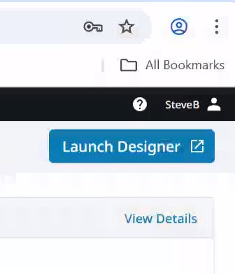

FYI. In my case it appears that the missing session-props were related to some corruption caused by the Windows Designer Launcher app V1.3.1.
I found that if I deleted the designer instance in that app and closed the app, then opened the project via the ‘Launch Designer’ button in the gateway, the project opened fine and the session-props were there. If I openned the app again and created a new designer instance, it crashed the session-props.
 ![2025-12-22_19-22-09](https://us1.discourse-cdn.com/inductiveautomation/original/3X/b/d/bd21da2ab3f46b6a47f8b73a1ee8e171b1745a5d.jpeg)
**Post date:** [December 22, 2025, 1:30pm UTC](https://forum.inductiveautomation.com/t/bug-10710-session-custom-properties-dissapearing/21553/39 "2025-12-22T13:30:41Z")
Having an easy reproducer would be very helpful to IA. Do you have a support ticket open you could report this via?
**Post date:** [December 23, 2025, 12:07am UTC](https://forum.inductiveautomation.com/t/bug-10710-session-custom-properties-dissapearing/21553/40 "2025-12-23T00:07:48Z")
I should have mentioned that. Yes I have a ticket open and I did pass on my logs, steps taken to reproduce it on my machine. I assume the corruption was occuring in memory cache where I couldn’t see it. I did send the cache files from %USERPROFILE%\.ignition\cache\.
I will also send them the app I have been using. I couldn’t find any logs from it though.
%APPDATA%\Inductive Automation\Designer Launcher\

Just an update on this one. It is still intermittently happenning and no root cause identified yet. I found this to be the easiest way to recover.
If you see this error, **do not close the Designer**. Go to **File \> Open Project** and select the _same_ project you are currently in. This forces a re-sync of the project resources without losing your current unsaved view changes.
