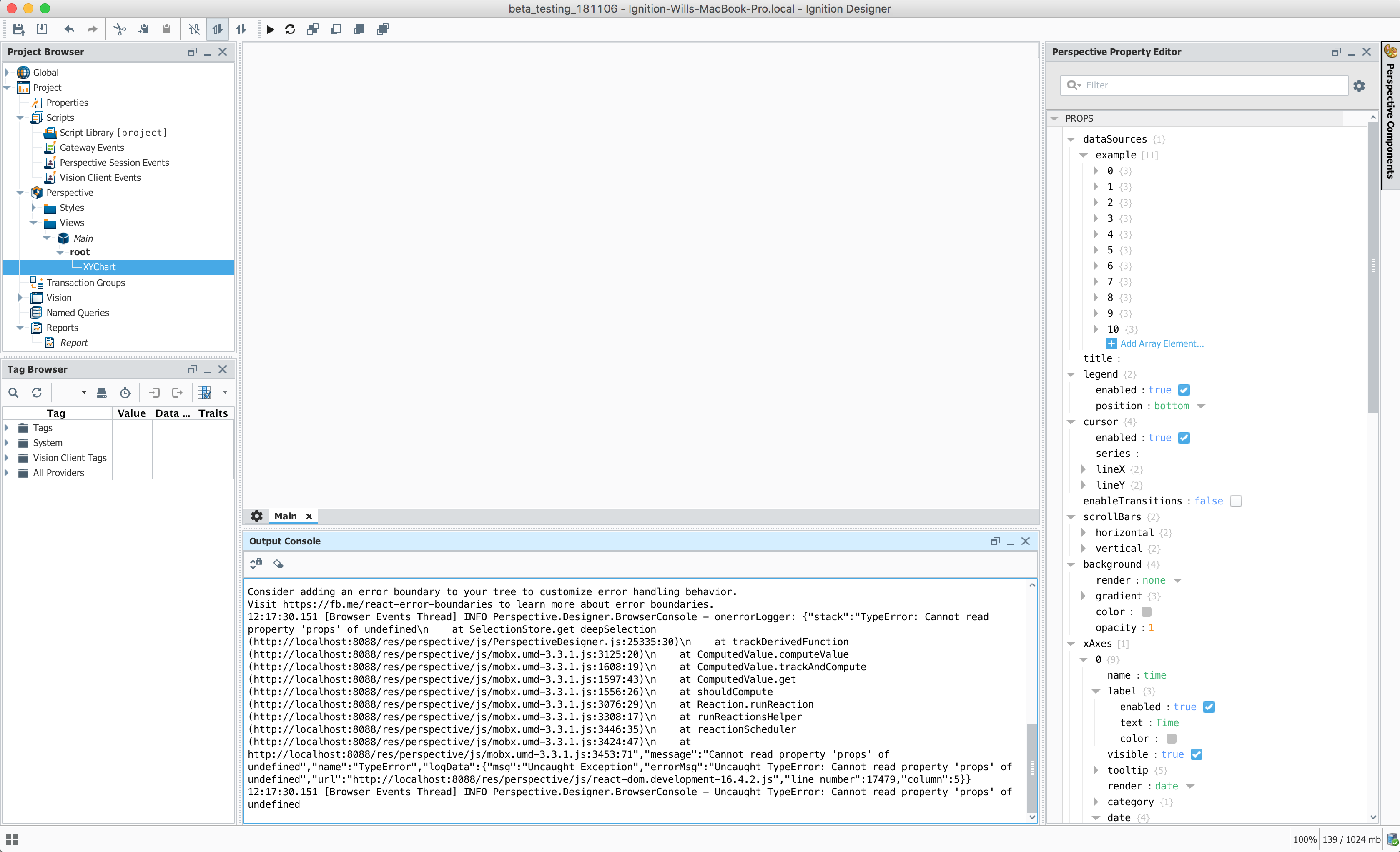

I’ve been having some sporadic “crashes” - for lack of a better word - of a Perspective view that I’m playing around with. There isn’t much in it, just an XY Chart. So far it has only happened when I’m not actively using the Designer. This time I had the Designer open in the background while working in some other programs (Chrome, Excel, etc), and then go back to find the View unresponsive/showing a white screen. This most recent one occurred somewhere in the 15-45 minute range from the time I opened the view. Doesn’t allow me to add components to it. Only recourse is to close the View - losing any unsaved work - and re-open it. Below is what is printed in the Designer Console and a screenshot of the unresponsive view in the Designer (can provide a gateway backup if that will help).
The Gateway and Designer are running on the same machine. 2015 MacBook Pro, 16 GB Ram, MacOSX Sierra 10.12.6. Ignition 8.0.0-beta0 (b2018110513).

Any chance your laptop is going to sleep during this time?
**Author:** ![WillMT10](https://avatars.discourse-cdn.com/v4/letter/w/7feea3/32.png) [@WillMT10](https://forum.inductiveautomation.com/u/WillMT10)\
**Post date:** [November 6, 2018, 9:18pm UTC](https://forum.inductiveautomation.com/t/bug-11007-perspective-view-crashes/20591/3 "2018-11-06T21:18:53Z")
Nope, it is set to never sleep and I was using it the entire time (from when I opened the view to when I went back to the Designer to see it had “crashed”).
**Author:** ![Carl.Gould](https://sea1.discourse-cdn.com/inductiveautomation/user_avatar/forum.inductiveautomation.com/carl.gould/32/7262_2.png) [@Carl.Gould](https://forum.inductiveautomation.com/u/Carl.Gould)\
**Post date:** [November 6, 2018, 9:29pm UTC](https://forum.inductiveautomation.com/t/bug-11007-perspective-view-crashes/20591/4 "2018-11-06T21:29:55Z")
It looks like you’re momentarily losing connection to the gateway. This is a known issue in the perspective designer that we’re working on.
**Post date:** [November 6, 2018, 9:36pm UTC](https://forum.inductiveautomation.com/t/bug-11007-perspective-view-crashes/20591/5 "2018-11-06T21:36:20Z")
Sounds good. Let me know if there is anything else I can provide or test.
