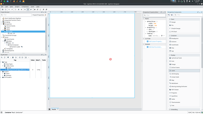

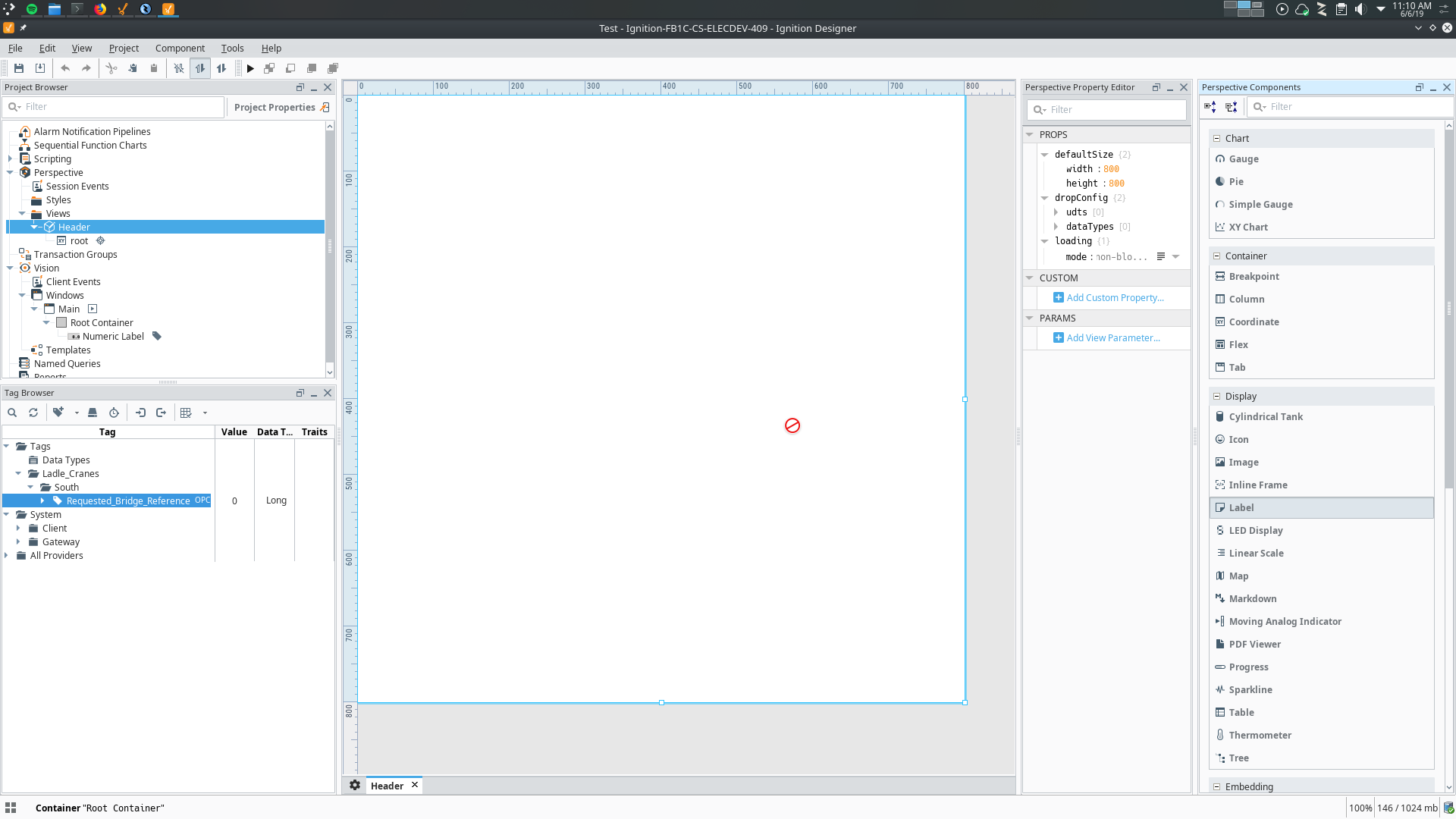

I’m check out Ignition 8, but I am unable to add any components to a perspective view. Whenever I click on a component and drag it to the view I just get a error mouse symbol.
 ![ignition-perspective-designer](https://us1.discourse-cdn.com/inductiveautomation/original/2X/c/c03687bafc18dd58023a1d5afa4b485b694717dd.png)
Also if I start up Designer I can add components to vision windows but once I try to add anything to a perspective view I then can’t add anything to vision windows as well. I just get the same error mouse symbol.
OS: KDE Neon, based on Ubuntu 18.04
Java: OpenJDK 1.8
Intel Graphics

I think we're tracking this already as FB11355, so I'm going to add that to the title.
Unfortunately the fix appears to be blocked on a complex bug in the JxBrowser library. Note from the vendor:
> Latest update from Team Dev on 5/9:
> ​Dear Joel,
> Unfortunately, the issue appeared to be more complex than we expected. We are not able to implement Drag&Drop on Linux in a heavyweight mode as we do it on macOS and Windows due to some restrictions of embedding a native window from one process to another on Linux itself.
> To my regret, the approach we used to make an improved Drag&Drop did not work and we are out of options at the moment. We plan to come back to this issue after the official release of JxBrowser 7.0.
> I will let you know once I have any updates regarding this issue.
> Thank you for understanding.
That it breaks Vision afterwards may be something we can address sooner, though...

Just as a note, drag & drop is non-functional on Linux but you can continue to add components to your views by clicking the component in the component menu then clicking again in the view. It’s not an ideal workaround, but if you don’t have another operating system available to design on it’s the only way right now.
