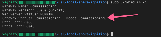

I think I might have found something that will get me by for the health checks. Debatably, perhaps this is enough altogether, although I think we could probably benefit from having both the Web Server Status and the Gateway Status included in the `StatusPing` JSON:
 ![14%20AM](https://us1.discourse-cdn.com/inductiveautomation/original/2X/5/5c4afe38d5be550d650a8fd1fb3903133d477363.png)
Thanks!
