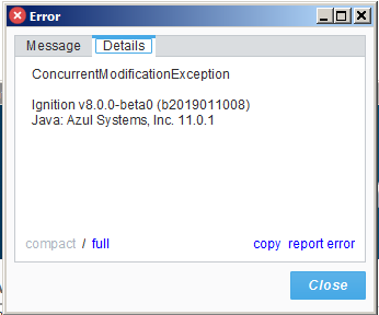

I am getting a ConcurrentModificationException when trying to open a project after installing the nightly build. It seems to pop up when it tries to start the perspective module.
![](https://us1.discourse-cdn.com/inductiveautomation/original/2X/8/8a5a182ca80fa4e939866dbad52505f1cffc6cc0.png)

To clarify I’m trying to open the designer.
**Post date:** [January 10, 2019, 7:12pm UTC](https://forum.inductiveautomation.com/t/bug-12013-concurrent-modification-exception-on-project-load/21794/3 "2019-01-10T19:12:40Z")
Can you click full and give us the whole stack trace?
**Post date:** [January 10, 2019, 7:36pm UTC](https://forum.inductiveautomation.com/t/bug-12013-concurrent-modification-exception-on-project-load/21794/4 "2019-01-10T19:36:58Z")
Looks related to the changes made to get the Perspective module to load. I’ll have a fix up shortly, should hopefully get merged in and into the next nightly.

java.util.ConcurrentModificationException
at java.base/java.util.ArrayList$Itr.checkForComodification(Unknown Source)
at java.base/java.util.ArrayList$Itr.next(Unknown Source)
at com.inductiveautomation.ignition.designer.IgnitionDesigner.loadProject(IgnitionDesigner.java:903)
at com.inductiveautomation.ignition.designer.IgnitionDesigner$StartupProjectDialogHandler$1.run(IgnitionDesigner.java:2027)
at java.base/java.lang.Thread.run(Unknown Source)
Ignition v8.0.0-beta0 (b2019011008)
Java: Azul Systems, Inc. 11.0.1

This issue was fixed in the build that was uploaded on 1/11. Please let us know if you continue to see this behavior after upgrading.
