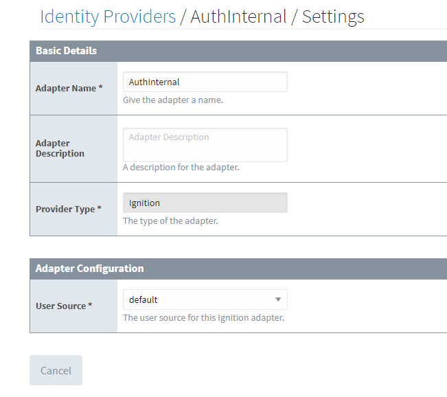

I created an Ignition Identity Provider, based on the “default” user source, where two roles have been set (Administrator and TestRole).
 ![](https://us1.discourse-cdn.com/inductiveautomation/original/2X/a/a0fc5410873a5bd65f4fcc562534888035001cc7.png)

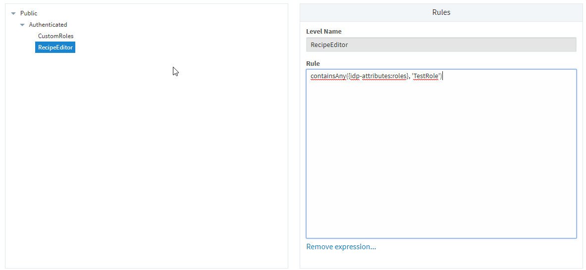

Then, I set a Security Level Rule in my Identity Provider for the security level “RecipeEditor”:
 ![](https://us1.discourse-cdn.com/inductiveautomation/original/2X/4/415ba33b420edffcd698343511fd5d804f815daf.png)

**Author:** ![jspecht](https://sea1.discourse-cdn.com/inductiveautomation/user_avatar/forum.inductiveautomation.com/jspecht/32/6465_2.png) [@jspecht](https://forum.inductiveautomation.com/u/jspecht)\
**Post date:** [December 19, 2018, 4:07pm UTC](https://forum.inductiveautomation.com/t/bug-12099-security-level-rules/21494/2 "2018-12-19T16:07:47Z")
Hi -
Our QA team found that same bug a few days back and the fix got merged in last night. Could you update to the latest nightly build and let us know if that fixes the issue?
