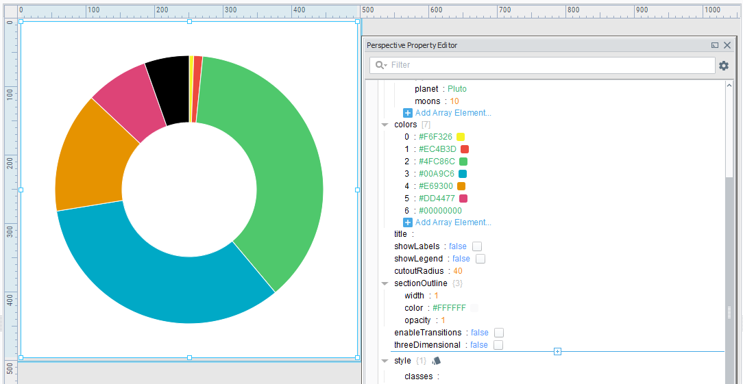

![PieChartBug](https://us1.discourse-cdn.com/inductiveautomation/original/2X/6/61a9481cb100e088c80bb26797016e6653d71b89.png)
When trying to set the color of a series on a perspective pie chart the color turns to black if the opacity is not 100%. If i am doing this wrong please disregard but i have found no other way.

Hi,
Good catch! You’re not doing anything wrong. At the moment, 8 digit hex isn’t supported by the chart library. We are working to resolve this issue, either through 8 digit hex support or some other means of applying opacity to individual series. We will get back to you soon. Thanks for the report.
-Yousuf

Okay, I’m going to open up a ticket. We’ll need to add opacity as a prop, which may change the structure a bit. If there’s anything else you think might be useful, please let us know.
Thanks,
-Yousuf
EDIT 2/10/2020: The nightly build available today fixed the issue, allowing opacity to be set on the wedges.
