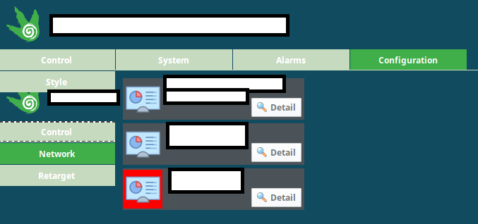

I have a north and west docked window. The north drives visibility of tab strips on the west.
When I select between tabs… there’s quite a repaint bug. I haven’t had this issue before.
![image](https://us1.discourse-cdn.com/inductiveautomation/original/2X/2/20d1f2179706b4e39be56419c9d3fd73a4f8dcb2.png)
**Post date:** [February 25, 2019, 4:37pm UTC](https://forum.inductiveautomation.com/t/bug-12883-repaints-of-tab-strip/22847/2 "2019-02-25T16:37:42Z")
Could you upload an export of those docked windows?

Are you using any transparency?
**Author:** ![joshdunstan](https://sea1.discourse-cdn.com/inductiveautomation/user_avatar/forum.inductiveautomation.com/joshdunstan/32/43306_2.png) [@joshdunstan](https://forum.inductiveautomation.com/u/joshdunstan)\
**Post date:** [February 25, 2019, 9:11pm UTC](https://forum.inductiveautomation.com/t/bug-12883-repaints-of-tab-strip/22847/5 "2019-02-25T21:11:53Z")
No I even set the tab strips to have a background and it had no effect
**Post date:** [February 25, 2019, 9:45pm UTC](https://forum.inductiveautomation.com/t/bug-12883-repaints-of-tab-strip/22847/6 "2019-02-25T21:45:49Z")
Are you sure you changed all of your tab strip’s background colors? I was able to reproduce a painting issue, but only when at least one tab strip was set to a transparent background. Either way, I’ve filed a ticket for us to investigate internally.

The Tab Strip has couple of rendering issues:
1 Random graphic left overs in the background after you click any tab, see tab strip next to chart.
2 After running the mouse over the tabs little white stars appear on the corners, see RH example below.

**Post date:** [May 9, 2019, 10:22pm UTC](https://forum.inductiveautomation.com/t/bug-12883-repaints-of-tab-strip/22847/10 "2019-05-09T22:22:18Z")
This issue was fixed in the 8.0.2 nightly build that was uploaded yesterday (5/8)

Hello,
I have the same issue with Ignition 7.9.
When the window containing the tab strip is opened for the first time, I have this bug :
 ![image](https://us1.discourse-cdn.com/inductiveautomation/original/2X/7/7575be86cd0431a6ac0753df8aea8ff41be4ccf6.png)
My tab strip uses Transparency.
When I drag the mouse over it, it repaints normally.
Any way to get rid of that issue?

**Author:** ![ayu](https://sea1.discourse-cdn.com/inductiveautomation/user_avatar/forum.inductiveautomation.com/ayu/32/16635_2.png) [@ayu](https://forum.inductiveautomation.com/u/ayu)\
**Post date:** [May 5, 2020, 12:10am UTC](https://forum.inductiveautomation.com/t/bug-12883-repaints-of-tab-strip/22847/14 "2020-05-05T00:10:55Z")
Hi,
This issue was fixed in 8.0.2, but don’t believe a fix was backported to 7.9. The painting issues you are seeing stems from how opacity is handled. If possible, I would avoid using transparent colors for tab strips for the time being.
