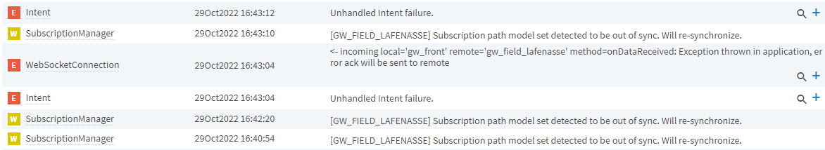

**Author:** ![pascal.fragnoud](https://sea1.discourse-cdn.com/inductiveautomation/user_avatar/forum.inductiveautomation.com/pascal.fragnoud/32/24728_2.png) [@pascal.fragnoud](https://forum.inductiveautomation.com/u/pascal.fragnoud)\
**Post date:** [November 21, 2022, 8:59am UTC](https://forum.inductiveautomation.com/t/bug-13789-gateway-logs-unhandled-intent-failure/24691/8 "2022-11-21T08:59:46Z")
Hello there,
I'm seeing this error message in my logs, and I have no idea what it means or what it comes from.
It seems there were a few occurrences at the end of last month, every day at the same time (the one on October 31 that looks to be one hour early is explained by the switch to winter time on October 30 (I'm in France))
 ![image](https://us1.discourse-cdn.com/inductiveautomation/original/3X/d/9/d96b1539196bbe725c2c572ca78ab40622e91e78.png)
Here are the ones from October 29 without filters, you can see they seem to happen at the same time as `WebSocketConnection` or `SubscriptionManager` errors.
 ![image](https://us1.discourse-cdn.com/inductiveautomation/original/3X/3/6/3606e5c9f4732fa73ae14a2cce815fe175c1bc29.png)
Then, the error stopped for a while, and started showing up again 2 days ago, but now more regularly:
 ![image](https://us1.discourse-cdn.com/inductiveautomation/original/3X/b/b/bb770212d2ea8c125fd3906329bd64ad50322bb6.png)
It appears almost every hour, with a few gaps or 'duplicates'.
A lot (but not all) of them are accompanied by either a `SebSocketConnection` error or `SubscriptionManager` warning.
What do I do now ? Where do I look, what do I test ?
I'm running it by the forum's users before taking it to support, just in case (the time difference between support and France makes the process quite slow :X)

I've never seen "Intent" in Ignition. I've familiar with the concept as used in Android--perhaps there's a Perspective Mobile app that is waking up and sending these?
**Post date:** [November 21, 2022, 1:16pm UTC](https://forum.inductiveautomation.com/t/bug-13789-gateway-logs-unhandled-intent-failure/24691/10 "2022-11-21T13:16:56Z")
It's a gateway network thing.
Cut off in that screenshot should be a "+" to the right that hopefully has an exception stack trace.

Yes there is, though I can't make much of it:

**Post date:** [November 21, 2022, 1:26pm UTC](https://forum.inductiveautomation.com/t/bug-13789-gateway-logs-unhandled-intent-failure/24691/12 "2022-11-21T13:26:40Z")
> [@Kevin.Herron](#):
Similar purpose? (Subscribable cross-process messaging in Android, fwiw.)
> [@pascal.fragnoud](#):
Indeed. It looks like a message deserialization didn't get far enough for the trace to even show what _kind_ of message.

Hello Kevin,
Any clue ?
Should I open a ticket with support ?
**Post date:** [November 23, 2022, 3:39pm UTC](https://forum.inductiveautomation.com/t/bug-13789-gateway-logs-unhandled-intent-failure/24691/14 "2022-11-23T15:39:02Z")
Probably make a support ticket, not really my area of expertise.
Looking at the stack trace though it just looks like a comms timeout between 2 gateways. Maybe a firewall interfering or something. Don't know.

Alright, thanks.
My ticket list is getting longer than winter nights in the artic 😃
