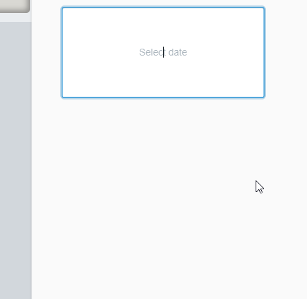

**Author:** ![apgilber](https://avatars.discourse-cdn.com/v4/letter/a/eb9ed0/32.png) [@apgilber](https://forum.inductiveautomation.com/u/apgilber)\
**Post date:** [June 12, 2019, 5:18pm UTC](https://forum.inductiveautomation.com/t/bug-13954-date-picker-on-a-popup-in-perspective/25086/6 "2019-06-12T17:18:26Z")
Little goofy behavior that I haven’t figured out yet. If I put a date time input object on a popup with a specific format property the calendar will show up behind the popup that the object is on. If I change the format it will show up on the popup.
This format works fine on a popup
 ![image](https://us1.discourse-cdn.com/inductiveautomation/original/2X/9/997f5fc48a22b9e050eea0e3b9f8c480de388696.png)
 ![image](https://us1.discourse-cdn.com/inductiveautomation/original/2X/0/0c4e78464332371da4a45b30de448bf814bf0d39.png)
If I change the format to “ll” and click on the object the blue box shows up like it is selected but the calendar isn’t shown. I dragged the popup over and saw the calendar behind it.
 ![image](https://us1.discourse-cdn.com/inductiveautomation/original/2X/2/2732a931da586448ce86681f779385b22db1a1ee.png)
 ![image](https://us1.discourse-cdn.com/inductiveautomation/original/2X/b/bb6ad4d16c5f77d7883ce4e5d23ce9cc2c5d11a0.png)
If you navigate to this view rather than open it as a popup it works fine with both format types.

**Author:** ![cmallonee](https://sea1.discourse-cdn.com/inductiveautomation/user_avatar/forum.inductiveautomation.com/cmallonee/32/6416_2.png) [@cmallonee](https://forum.inductiveautomation.com/u/cmallonee)\
**Post date:** [June 25, 2019, 3:26pm UTC](https://forum.inductiveautomation.com/t/bug-13954-date-picker-on-a-popup-in-perspective/25086/11 "2019-06-25T15:26:40Z")
Either the formatting change or avoiding use of DateTime Inputs in Popups. Replacing a DateTime Input with a DateTime Picker would work, but replacing a component entirely would result in you needing to repair bindings, whereas changing the formatting _should_ be a fairly unobtrusive change.
