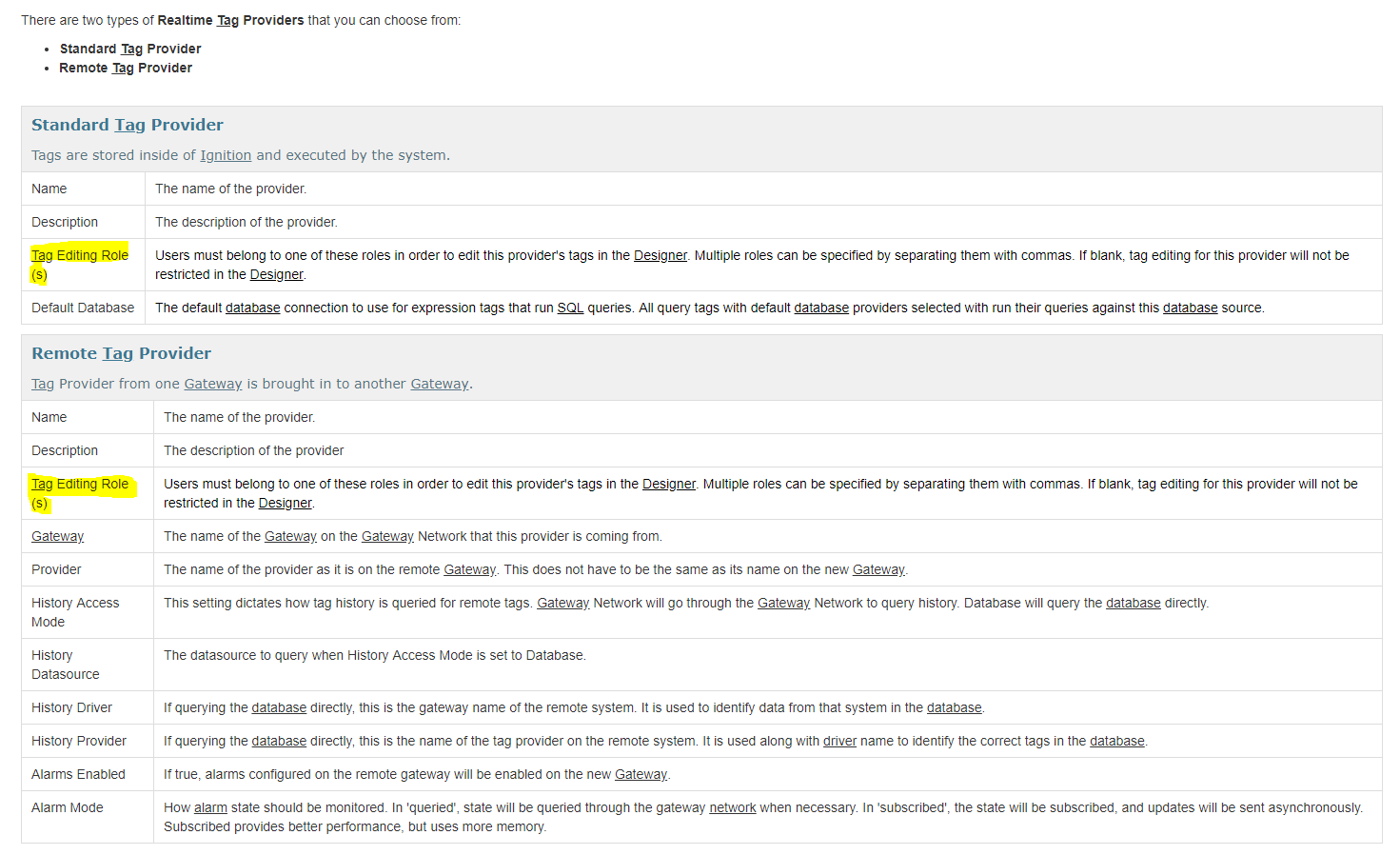

How can I grant permission for tag editor in Ignition 8.0.2-rc? I can’t found Tag Editing Role (s) in real time tag provider setting as belows.
Real time tag provider setting
 ![image](https://us1.discourse-cdn.com/inductiveautomation/original/2X/7/719ab58e5a9f957f45a2774773d1e272e6a528d4.png)
[https://docs.inductiveautomation.com/display/DOC80/Tag+Providers](https://docs.inductiveautomation.com/display/DOC80/Tag+Providers)

Hi Apisit
I will write up an internal ticket to look into the issue. However, if you are trying to use this functionality as it exits now you don’t have to specify those roles and you can go ahead and connect to any real time tag provider you want based on the documentation provided.

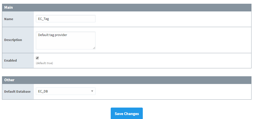

Hi anjoroge,
Is this feature available on Ignition8.0.3?
 ![image](https://us1.discourse-cdn.com/inductiveautomation/original/2X/c/c1e0b29ec52239b621b9a6b3020ef48354cb50fe.png)
**Post date:** [August 14, 2019, 2:35pm UTC](https://forum.inductiveautomation.com/t/bug-14103-tag-editor-role-missing-on-the-edit-real-time-tag-provider-page-in-8-0/25481/4 "2019-08-14T14:35:13Z")
This feature has not yet been re-implemented in 8.0 with the new tag system. This topic will be updated once it has been.

For posterity, 8.0.16 added a `Tag Editing Permissions` setting to Standard Tag Providers which effectively replaces the functionality of the old setting.
