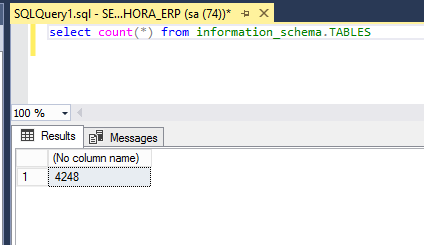

**Author:** ![informatica](https://avatars.discourse-cdn.com/v4/letter/i/3ab097/32.png) [@informatica](https://forum.inductiveautomation.com/u/informatica)\
**Post date:** [June 27, 2019, 8:17am UTC](https://forum.inductiveautomation.com/t/bug-14319-sql-query-builder-is-very-slow-and-overloads-the-pc/26084/5 "2019-06-27T08:17:50Z")
Good morning.
The database has got more than 4000 tables. I had not checked. Excuse.
![image](https://us1.discourse-cdn.com/inductiveautomation/original/2X/f/f59bdffdb3ad4a429d0abb90e516436287627619.png)
But, ¿Why does “Database query browser” load perfectly and “SQL Query Builder” never load?
Best regards.
**Author:** ![KathyApplebaum](https://sea1.discourse-cdn.com/inductiveautomation/user_avatar/forum.inductiveautomation.com/kathyapplebaum/32/7261_2.png) [@KathyApplebaum](https://forum.inductiveautomation.com/u/KathyApplebaum)\
**Post date:** [June 27, 2019, 2:09pm UTC](https://forum.inductiveautomation.com/t/bug-14319-sql-query-builder-is-very-slow-and-overloads-the-pc/26084/6 "2019-06-27T14:09:28Z")
They are different systems doing different things – the query builder lets you do graphical building of queries, so it’s a more complex system.
