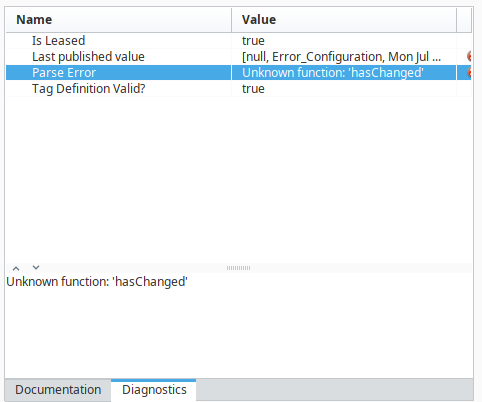

I am trying to implement a counter for a tag. Currently the units tags are created through perspective session due the future scaling. As such, i require the counter to be created dynamically at the same time a new units tags are created, hence why an expression tag is being used.
I need to add 1 to a ‘Count’ tag whenever another tag becomes 1.
For some reason i cannot get ‘hasChanged’ to cooperate.
Is this function bugged and if so, when is it expected to be available again?
 ![image](https://us1.discourse-cdn.com/inductiveautomation/original/2X/f/f1985de0b8234344da7a24ca362015ed09f92626.png)
 ![image](https://us1.discourse-cdn.com/inductiveautomation/original/2X/9/9d53121b2c572ea4cad04d5e5659e79301eebbbc.png)

I don’t see any current bug reports on it, but I’m able to replicate the issue in 8.0.3. I’ll open a ticket for this. Thanks!

This issue was fixed in the 8.0.4 Nightly build that was uploaded today (7/26).
