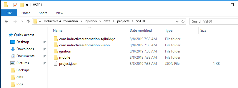

**Author:** ![dion.botha](https://avatars.discourse-cdn.com/v4/letter/d/46a35a/32.png) [@dion.botha](https://forum.inductiveautomation.com/u/dion.botha)\
**Post date:** [August 8, 2019, 5:43pm UTC](https://forum.inductiveautomation.com/t/bug-14641-error-reading-updated-project-from-gateway/27139/3 "2019-08-08T17:43:15Z")
Hi Paul, I am seeing something similar when trying to save some of my projects:
> java.lang.IllegalStateException: Module root children are nameless.
> at com.inductiveautomation.ignition.common.project.resource.ResourcePath.getChild(ResourcePath.java:195)
> at com.inductiveautomation.ignition.designer.project.DesignerProjectTreeImpl.recoverFolder(DesignerProjectTreeImpl.java:644)
> at java.base/java.lang.Iterable.forEach(Unknown Source)
> at com.inductiveautomation.ignition.designer.project.DesignerProjectTreeImpl.validateFolderStructure(DesignerProjectTreeImpl.java:635)
> at com.inductiveautomation.ignition.designer.project.DesignerProjectTreeImpl.applyChange(DesignerProjectTreeImpl.java:512)
> at com.inductiveautomation.ignition.designer.IgnitionDesigner.pullAndResolve(IgnitionDesigner.java:1553)
> at com.inductiveautomation.ignition.designer.IgnitionDesigner.handleSave(IgnitionDesigner.java:1316)
> at com.inductiveautomation.ignition.designer.IgnitionDesigner$Handler.handleSaveAction(IgnitionDesigner.java:2618)
> at com.inductiveautomation.ignition.designer.IgnitionDesigner$Handler$5.actionPerformed(IgnitionDesigner.java:2222)
> at java.desktop/javax.swing.AbstractButton.fireActionPerformed(Unknown Source)
> at java.desktop/javax.swing.AbstractButton$Handler.actionPerformed(Unknown Source)
> at java.desktop/javax.swing.DefaultButtonModel.fireActionPerformed(Unknown Source)
> at java.desktop/javax.swing.DefaultButtonModel.setPressed(Unknown Source)
> at java.desktop/javax.swing.plaf.basic.BasicButtonListener.mouseReleased(Unknown Source)
> at com.jidesoft.plaf.basic.BasicJideButtonListener.mouseReleased(Unknown Source)
> at java.desktop/java.awt.AWTEventMulticaster.mouseReleased(Unknown Source)
> at java.desktop/java.awt.Component.processMouseEvent(Unknown Source)
> at java.desktop/javax.swing.JComponent.processMouseEvent(Unknown Source)
> at java.desktop/java.awt.Component.processEvent(Unknown Source)
> at java.desktop/java.awt.Container.processEvent(Unknown Source)
> at java.desktop/java.awt.Component.dispatchEventImpl(Unknown Source)
> at java.desktop/java.awt.Container.dispatchEventImpl(Unknown Source)
> at java.desktop/java.awt.Component.dispatchEvent(Unknown Source)
> at java.desktop/java.awt.LightweightDispatcher.retargetMouseEvent(Unknown Source)
> at java.desktop/java.awt.LightweightDispatcher.processMouseEvent(Unknown Source)
> at java.desktop/java.awt.LightweightDispatcher.dispatchEvent(Unknown Source)
> at java.desktop/java.awt.Window.dispatchEventImpl(Unknown Source)
> at java.desktop/java.awt.EventQueue.dispatchEventImpl(Unknown Source)
> at java.desktop/java.awt.EventQueue$4.run(Unknown Source)
> at java.base/java.security.AccessController.doPrivileged(Native Method)
> at java.base/java.security.ProtectionDomain$JavaSecurityAccessImpl.doIntersectionPrivilege(Unknown Source)
> at java.desktop/java.awt.EventQueue$5.run(Unknown Source)
> at java.desktop/java.awt.EventQueue.dispatchEvent(Unknown Source)
> at java.desktop/java.awt.EventDispatchThread.pumpOneEventForFilters(Unknown Source)
> at java.desktop/java.awt.EventDispatchThread.pumpEventsForFilter(Unknown Source)
> at java.desktop/java.awt.EventDispatchThread.pumpEventsForHierarchy(Unknown Source)
> at java.desktop/java.awt.EventDispatchThread.pumpEvents(Unknown Source)
> at java.desktop/java.awt.EventDispatchThread.run(Unknown Source)
> Ignition v8.0.2 (b2019060511)
> Java: Azul Systems, Inc. 11.0.3
/projects folder:
 ![image](https://us1.discourse-cdn.com/inductiveautomation/original/2X/0/031bd7abe4013d868683b4dde7320afba87584ee.png)
A project that I am not able to save's project directory:
 ![image](https://us1.discourse-cdn.com/inductiveautomation/original/2X/7/7e79048a4c24ca7f50ad7d46d8cf000d25490213.png)
**Post date:** [August 8, 2019, 5:55pm UTC](https://forum.inductiveautomation.com/t/bug-14641-error-reading-updated-project-from-gateway/27139/4 "2019-08-08T17:55:16Z")
Actually, the error only comes up after I have saved a project after re-configuring auto-login (all projects that previously had auto-login configured seemed to have lost those project properties due to the upgrade)

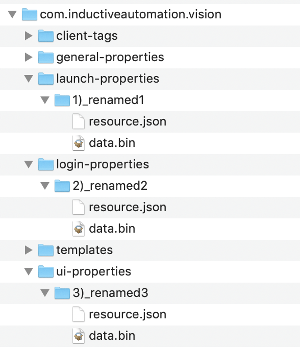

**Post date:** [August 9, 2019, 3:41pm UTC](https://forum.inductiveautomation.com/t/bug-14641-error-reading-updated-project-from-gateway/27139/5 "2019-08-09T15:41:02Z")
![image](https://us1.discourse-cdn.com/inductiveautomation/original/2X/4/42cff7ef6a70fade7a010f465490f6098eb7c08a.png)
This issue is caused by the strange looking directories with “…renamed…” in the name. A quick manual fix would be to close any open Designers, cut and paste the resources.json and data.bin files from the inner to the outer folder (e.g. from 1)\_renamed1 into launch-properties), then delete the inner folder. You should then have your old login properties from before the project conversion from 7.x to 8.0.
This is a case of a weird resource name not being handled on upgrade; we’re looking into preventing this in the next release.

I just wanted to give a quick update. I was able to get around this issue by creating a copy of my project and working from the copy.
I will verify the folder structure when I am able to access the system again later this week.

This issue was fixed in the 8.0.4 nightly build that was uploaded yesterday (8/13).
**Author:** ![osolorzano](https://sea1.discourse-cdn.com/inductiveautomation/user_avatar/forum.inductiveautomation.com/osolorzano/32/6432_2.png) [@osolorzano](https://forum.inductiveautomation.com/u/osolorzano)\
**Post date:** [August 13, 2019, 5:38pm UTC](https://forum.inductiveautomation.com/t/bug-14641-error-reading-updated-project-from-gateway/27139/8 "2019-08-13T17:38:41Z")
Just as some extra clarification if your project has been upgraded from 7.9.x to 8.0.x before these changes and you end up with those oddly named folders inside the project, the designer will still throw the original error. It’s just that after these changes, those folders should no longer be created while upgrading or restoring gateway backups from 7.9.
