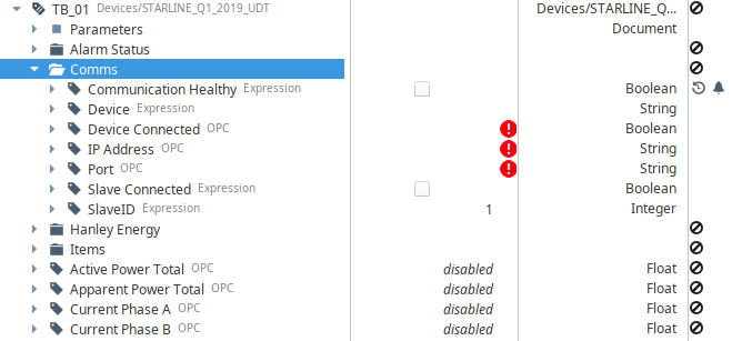

When we disable an instance of a UDT it only disables tags on the top level. In our case we have tags in a folder yet the folder has a disabled icon but the tags are still live in the folder.
![image](https://us1.discourse-cdn.com/inductiveautomation/original/2X/5/562665a1b7628834486817e55e7b907ca6637a71.png)
Version 8.0.4 Nightly

Confirmed. I added a ticket to get this fixed.

When is this issue planned to be fixed?
