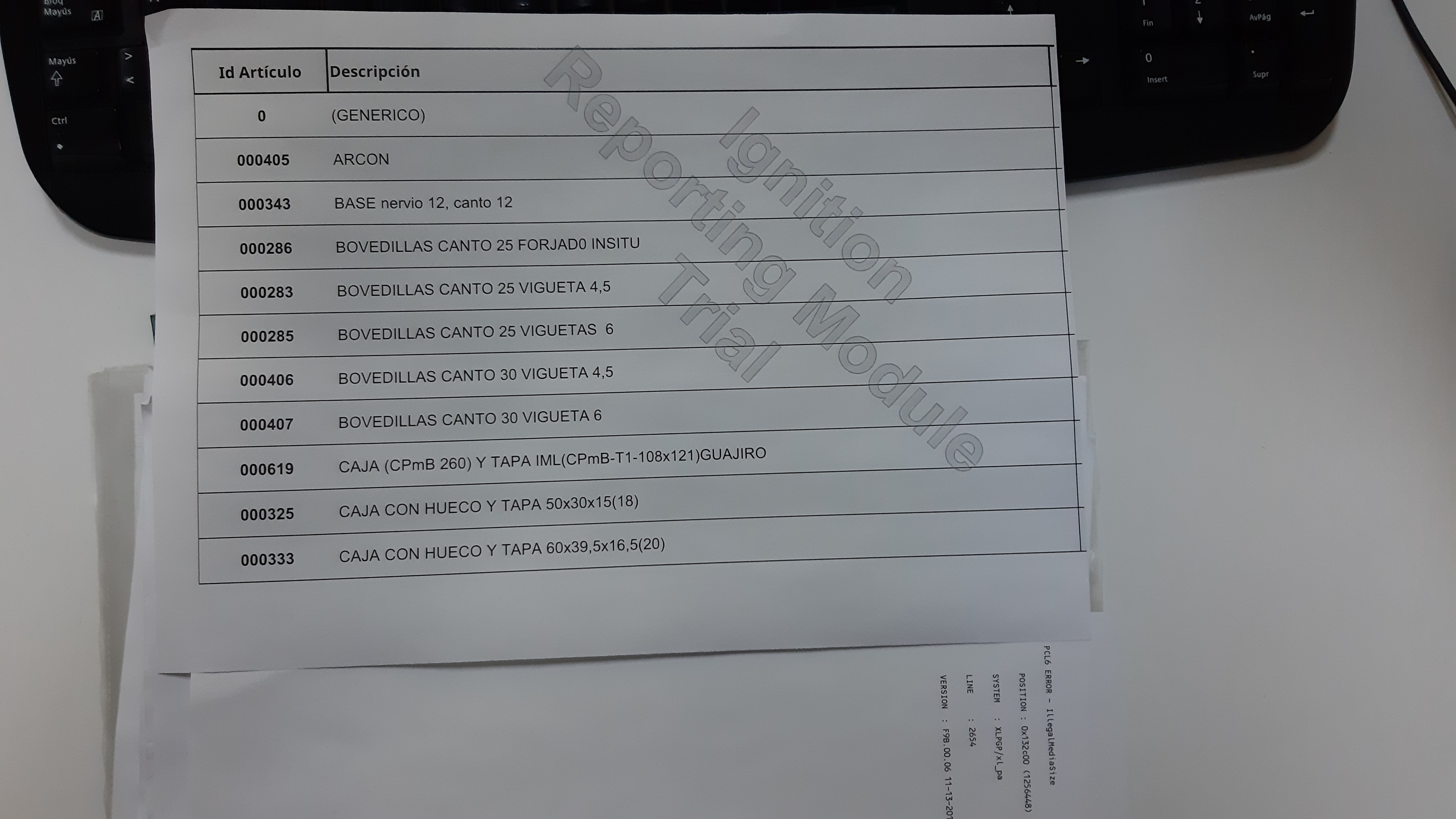

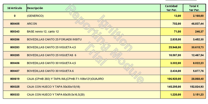

In Ignition **8.0.3** , when you **print** a report from a “ **Report Viewe** r”, it is not possibble “fit to page”. So, the report is **truncated**.
**There is no property or method** in the “Report Viewer” component that allows you to do this.
**Report in “Report Viewer”:**
 ![image](https://us1.discourse-cdn.com/inductiveautomation/original/2X/d/d77046aa10d91c1467048d65bb6f9bc5ccbe28c8.png)
**Printed report (truncated):**
 ![image](https://us1.discourse-cdn.com/inductiveautomation/original/2X/8/8eda923769f706071d3f36fedaef50fdd12889e2.jpeg)
On the other hand, with the function “**[system.print.createPrintJob](https://docs.inductiveautomation.com/display/DOC80/system.print.createPrintJob)**”, it is possible to do “fit to page”.
Best Regards.

Thanks for catching this. I don’t see a ticket for this, so I’ll make one.
