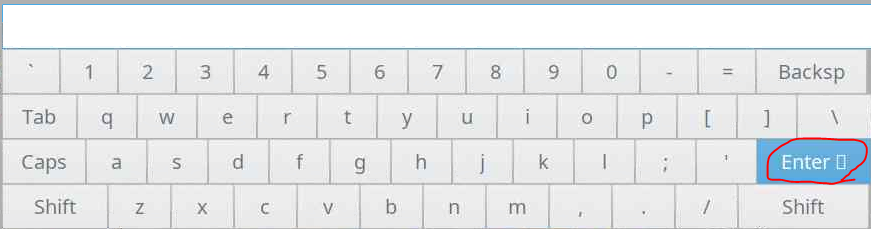

Hi,
There is a rectangle icon in the “Enter” key of the virtual keyboard. Is it a bug?
(my version is Ignition 8.0.4 Nightly on Win10 platform)
 ![Capture](https://us1.discourse-cdn.com/inductiveautomation/original/2X/b/bcec100ec8c838659ca06baecf3e08e293ff7174.png)
**Author:** ![alexlu](https://sea1.discourse-cdn.com/inductiveautomation/user_avatar/forum.inductiveautomation.com/alexlu/32/65795_2.png) [@alexlu](https://forum.inductiveautomation.com/u/alexlu)\
**Post date:** [September 5, 2019, 8:10pm UTC](https://forum.inductiveautomation.com/t/bug-14921-icon-display-of-enter-key-in-virtual-keyboard/28026/2 "2019-09-05T20:10:57Z")
Dawei,
Thanks for bringing this to our attention. Looks like the return key unicode is missing on Windows clients. I’ve opened a ticket for this.
EDIT: This is fixed in 8.0.15.
