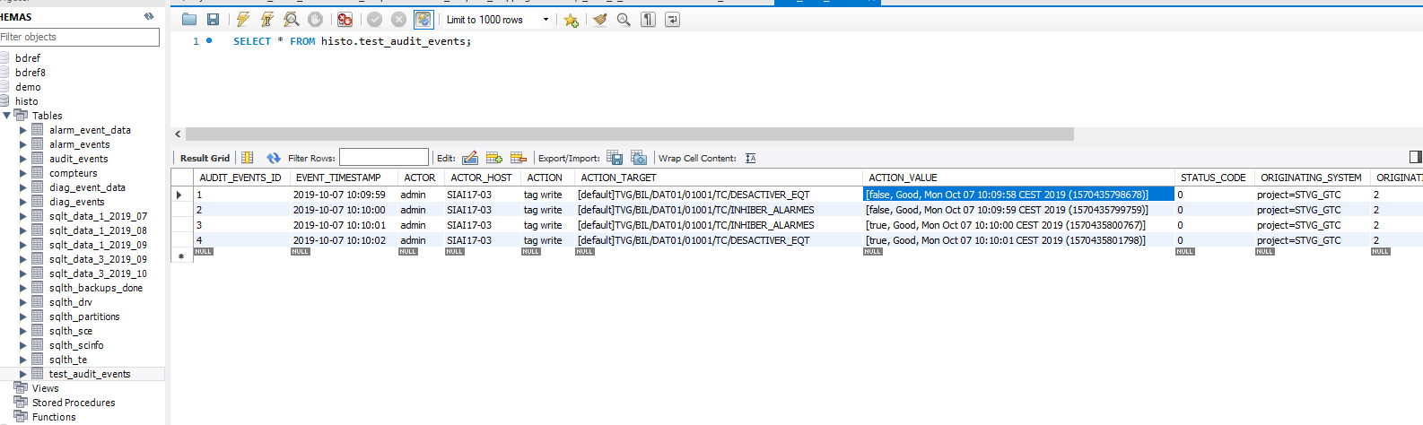

Hi @paul-griffith,
With the standart Database audit profile, the **ACTION\_VALUE** column in the audit table is filled with Qualified Value instead of value:
```auto
[false, Good, Mon Oct 07 10:09:58 CEST 2019 (1570435798678)]
instead of:
```auto
false
 ![image](https://us1.discourse-cdn.com/inductiveautomation/original/2X/3/3100ae018ccb8cc2467dba6d267c1ad80882abb6.png)
I don’t think it’s intentional. Tested with Ignition 8.0.5-nightly 12/09.
**Post date:** [October 7, 2019, 3:38pm UTC](https://forum.inductiveautomation.com/t/bug-15145-action-value-of-audit-table-contain-qualified-value-instead-of-the-value/28868/2 "2019-10-07T15:38:00Z")
I don’t necessarily think this is a regression - I think it’s related to an unplanned change made to the way QualifiedValues are passed through the tag write system. I’ll file a ticket, but I don’t know if it’s actually worth changing.
**Author:** ![mazeyrat](https://sea1.discourse-cdn.com/inductiveautomation/user_avatar/forum.inductiveautomation.com/mazeyrat/32/10955_2.png) [@mazeyrat](https://forum.inductiveautomation.com/u/mazeyrat)\
**Post date:** [October 7, 2019, 3:46pm UTC](https://forum.inductiveautomation.com/t/bug-15145-action-value-of-audit-table-contain-qualified-value-instead-of-the-value/28868/3 "2019-10-07T15:46:56Z")
Yes in v8 every value are Qualified value…
But the action\_value column in the audit table is a varchar in the database, and we are only interested by the value here, there is ever a status code and event\_timestamp columns.
As a side note, is there a built in function in the SDK to parse string [V, Q, T] to Qualified Value ?
**Author:** ![awalker](https://sea1.discourse-cdn.com/inductiveautomation/user_avatar/forum.inductiveautomation.com/awalker/32/6874_2.png) [@awalker](https://forum.inductiveautomation.com/u/awalker)\
**Post date:** [October 11, 2019, 2:24pm UTC](https://forum.inductiveautomation.com/t/bug-15145-action-value-of-audit-table-contain-qualified-value-instead-of-the-value/28868/4 "2019-10-11T14:24:43Z")
This issue was fixed in the 8.0.6 nightly build that was uploaded yesterday (10/10).
