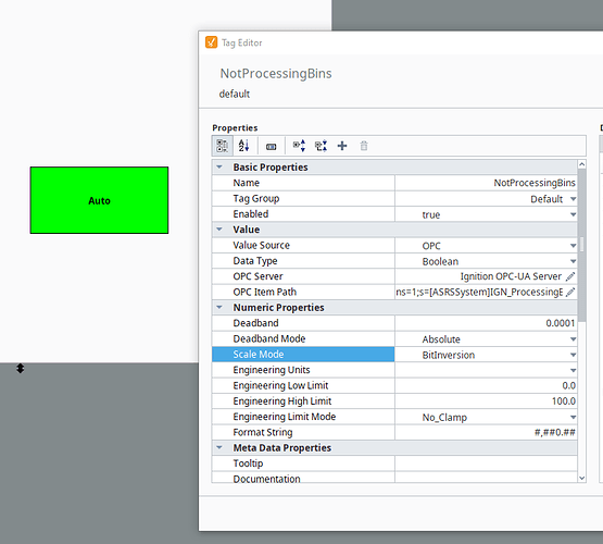

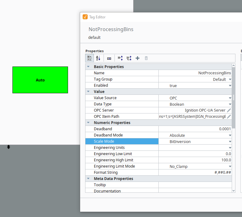

I have a Boolean OPC tag which I had inverted (Ignition to display True when False in PLC, and vice versa) in 7.9, which worked well. In 8.0.5 it doesn’t seem to work the same.
Changing the “Scale Mode” property between “Off” and “BitInversion” doesn’t have an effect on the tag value in 8.0.5.
 ![Off](https://us1.discourse-cdn.com/inductiveautomation/original/2X/d/d492970b60203bbf8ddc4932a871b8760b822bb7.png) ![Inverted](https://us1.discourse-cdn.com/inductiveautomation/original/2X/0/0de9319b8bb6c1248c2b1cff72da0b5f9e6e1c5f.png)

Thanks, this seems like a bug…

Having a similar issue, is this still a bug?
**Post date:** [March 3, 2020, 3:04pm UTC](https://forum.inductiveautomation.com/t/bug-15406-bit-inversion-inconsistency-ignition-7-9-to-8-0/29794/4 "2020-03-03T15:04:29Z")
Should be fixed in 8.0.7+
**Author:** ![curtis.hargreaves](https://avatars.discourse-cdn.com/v4/letter/c/f07891/32.png) [@curtis.hargreaves](https://forum.inductiveautomation.com/u/curtis.hargreaves)\
**Post date:** [March 3, 2020, 5:26pm UTC](https://forum.inductiveautomation.com/t/bug-15406-bit-inversion-inconsistency-ignition-7-9-to-8-0/29794/5 "2020-03-03T17:26:56Z")
Thank you, we were still running 8.0.6.
