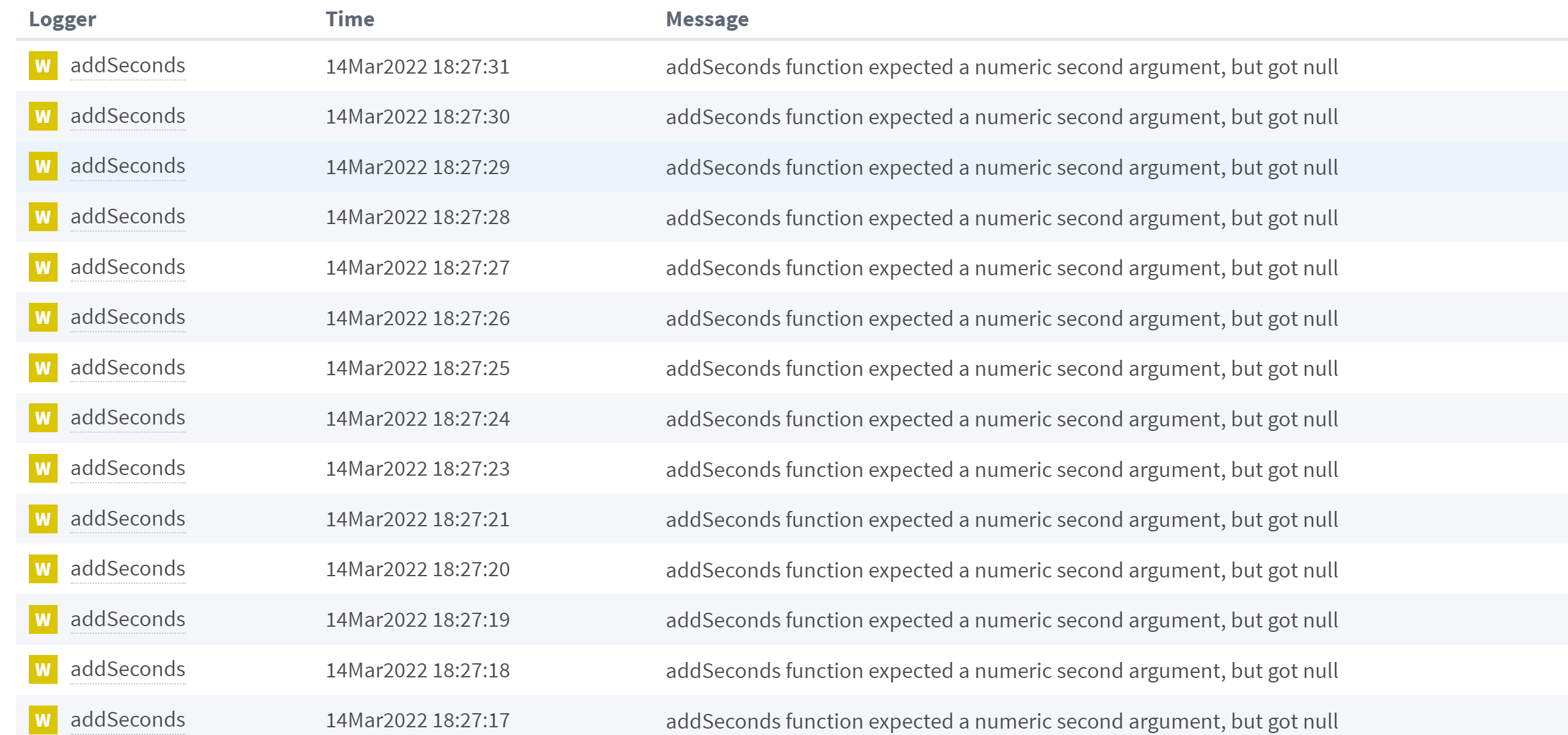

Hi, I have similar problem on 8.1.14
 ![image](https://us1.discourse-cdn.com/inductiveautomation/original/3X/e/9/e9b3e78b56cf094d70fc987c94204bded0710520.png)
Log tellme name of tag ‘StopTime’ , but this is used 138 times in project…
It’s possibile have completlty path in log?
Thanks
