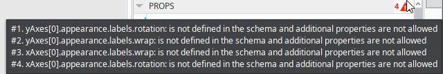

Hi, I drag-drop an XYChart in an empty View (12 columns) and there is 4 warnings/errors shown by default. Anyone can tell me how to make this disappear (look attachment)?

You can make them go away by deleting the property it mentions in each of those errors.
That said, we should change the default XYChart to make sure either:
A. Those properties are removed because they are not part of the schema.
OR
B. Those properties are added to the schema if they are supposed to be there.
