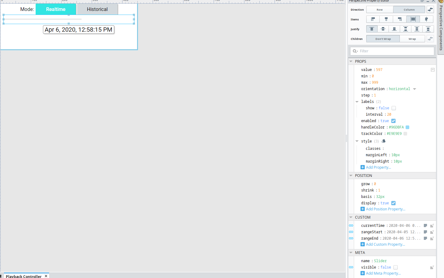

Perspective slider invisibility only makes part of the slider invisible in 8.0.10.

What are you doing to make it invisible? While I’m using 8.0.12 nightly, I don’t believe we changed anything that should affect this functionality.
I tried
`visibility: "hidden"`
and
`display: "none"`
and both of those worked for me.
Could you also provide a screenshot of the issue as you see it?

![slider](https://us1.discourse-cdn.com/inductiveautomation/original/2X/9/92b8be8aaf72c21c998660035d1ed20955b25e8b.png)
Setting the visibility false leaves the left part of the slider visible.
**Author:** ![cmallonee](https://sea1.discourse-cdn.com/inductiveautomation/user_avatar/forum.inductiveautomation.com/cmallonee/32/6416_2.png) [@cmallonee](https://forum.inductiveautomation.com/u/cmallonee)\
**Post date:** [April 6, 2020, 6:14pm UTC](https://forum.inductiveautomation.com/t/bug-16284-perspective-slider-invisibility/33715/4 "2020-04-06T18:14:53Z")
Oh, neat. I’ll open a ticket to get this fixed, but in the meantime you could always use `position.display` to determine whether the component is displayed.
As a second alternative, `display: none` as part of `props.style` works as well.
