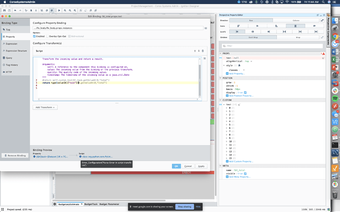

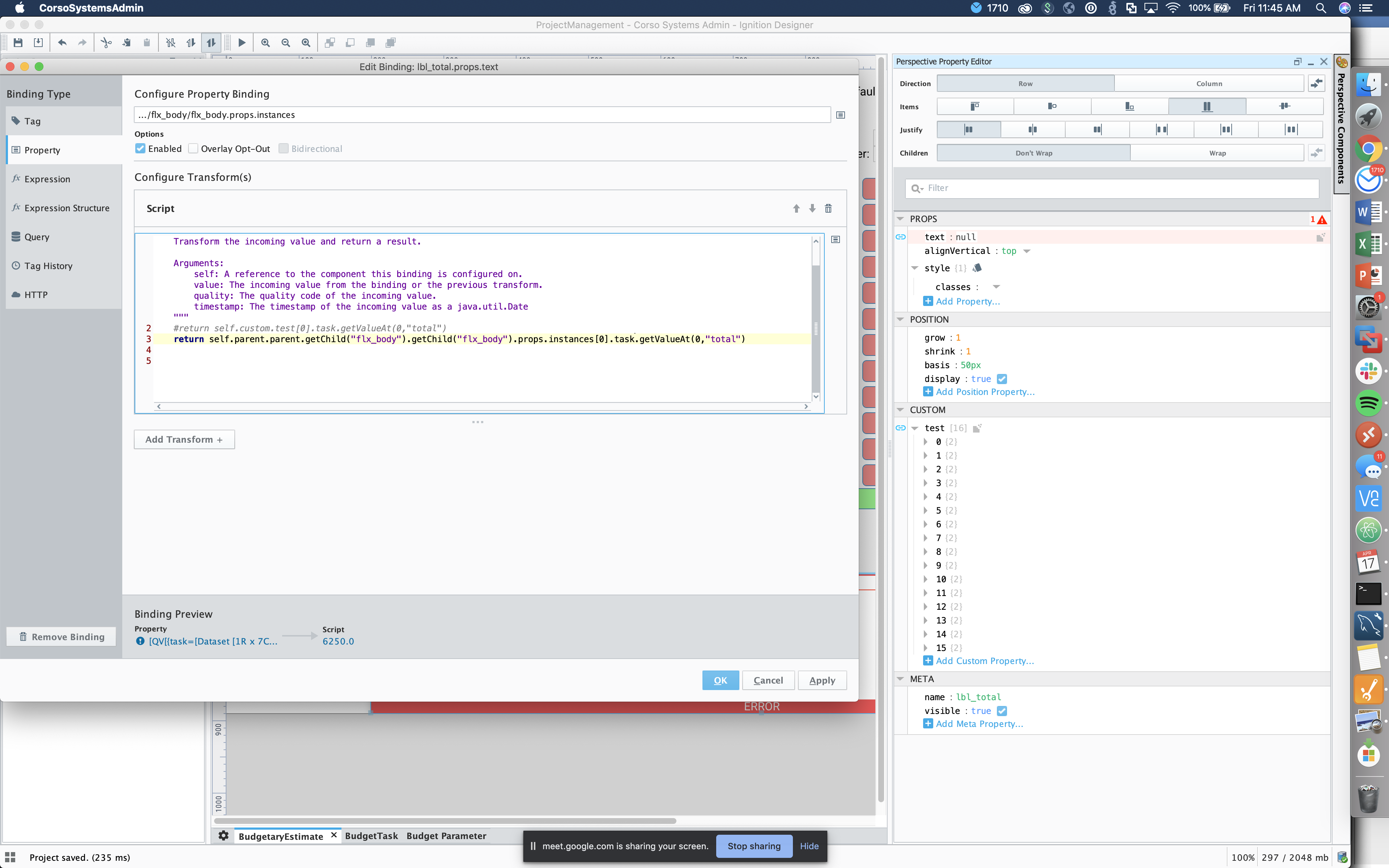

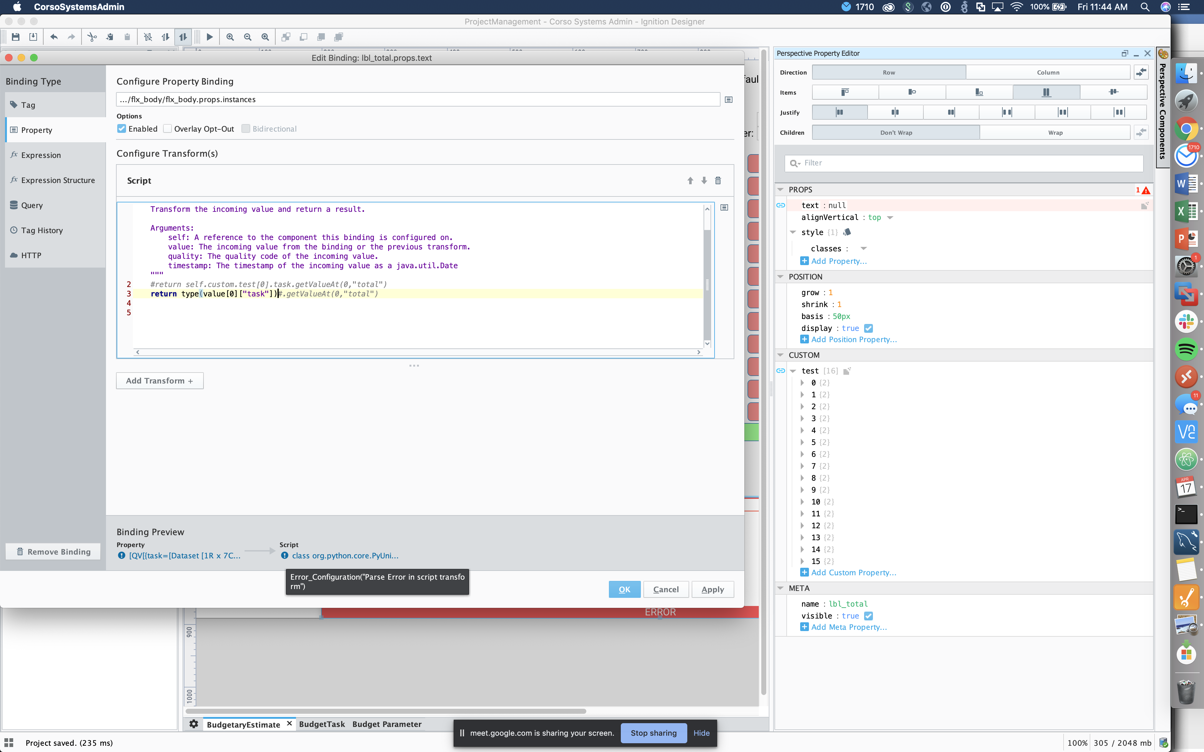

In 8.0.11, possibly earlier, haven’t tried it out yet, if you bind to the instances property on a flex repeater, and have a dataset in the item, doing value[0].dataSetName or value[0][“datasetName”] will return a string of “Dataset[1xN]” instead of the actual dataset.
If you reference the instances property directly in the script instead of using value… it works without issue.
 ![50%20AM](https://us1.discourse-cdn.com/inductiveautomation/original/2X/2/201ea733b86467d1e682be65e46b443a934d9c7e.png) ![22%20AM](https://us1.discourse-cdn.com/inductiveautomation/original/2X/f/ffb6ec962cc0f8cc5682ca88648821b1fe023211.png)
**Author:** ![Carl.Gould](https://sea1.discourse-cdn.com/inductiveautomation/user_avatar/forum.inductiveautomation.com/carl.gould/32/7262_2.png) [@Carl.Gould](https://forum.inductiveautomation.com/u/Carl.Gould)\
**Post date:** [May 1, 2020, 6:31pm UTC](https://forum.inductiveautomation.com/t/bug-16424-possible-bug-in-8-0-11-flex-repeater-instances-with-a-dataset-in-the-array-returns-a-string-instead-of-the-actual-dataset-in-a-script-transform/34015/2 "2020-05-01T18:31:20Z")
Yep, confirmed, this is a bug. We’ll get it fixed.
