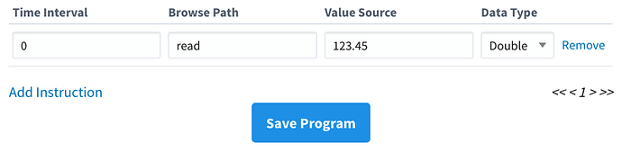

Hi, I think there is a problem in Programmable Device Simulator, when I go to edit a program and I then save, float’s or double’s decimal part goes to the integer part and integer part are multiplied by 10 each time that I save. So if I edit or add one instruction and then save, all the others instructions are changed in this way.

I’m not. I’m using “.” as the decimal separator. Are you tried what I said? I’m using Version: 8.0.11
**Post date:** [May 13, 2020, 5:50pm UTC](https://forum.inductiveautomation.com/t/bug-16490-problem-in-programmable-device-simmulator/34700/4 "2020-05-13T17:50:03Z")
I did - I can’t reproduce the issue. My guess was based on us doing some kind of number parsing on the backend; I’m not very familiar with how the programmable simulator works.
I made a new device simulator, edited the configuration, made a `readonly(123.45)` value source of type double. Then I saved the configuration, and went back to it - still 123.45. I added an integer `readonly(123)`, saved the program, went back to it - both values are still the same.

I tried what you did.
 ![Captura de pantalla 2020-05-13 a las 20.05.08](https://us1.discourse-cdn.com/inductiveautomation/original/2X/5/58c02dd9f15792acbf8f7322040e9e9ad0757d96.png)
I save and then try to edit. So, this is what I see. ![Captura de pantalla 2020-05-13 a las 20.05.26](https://us1.discourse-cdn.com/inductiveautomation/original/2X/0/0a90b2636978a30e3266d0271c31d02790fb0720.png)

Hi Jorgeibesi, if your region / locale is Spain, the standard is that folks would be using a “,” as a decimal separator, and a “.” as a thousands separator. Ignition is trying to respect the rules for the area of the world that your system says it’s in.
If you set your Value Source to “readonly(123,45)”, it will probably give you what you are looking for.

I’m gonna log this is a bug. The locale shouldn’t be taken into account here.

We have it duplicated now. Any Gateway setup to use a region that uses anything other than a period for a decimal separator is going to have issues with the built in functions for the simulator unless you want to use integers. The bug Kevin H filed will ultimately address these issues, but I am not seeing a workaround at this point.

That’s the locale of the designer. The issue is the locale of the gateway. Consider changing your gateways to ‘en’ until the bug is fixed.
