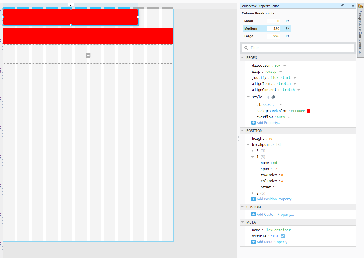

I think I have encountered a potential bug in the column container, I have a binding set up on a component to prevent an object going beyond a certain size for a particular breakpoint. This has resulted in some of my bindings giving a span above 12. The issue is that this causes all other components with the same row index to scale to the highest span. For example, I have an item that has a span of 24, so an item with a span of 12 will effectively have a span of 6.

**Author:** ![michael2](https://avatars.discourse-cdn.com/v4/letter/m/3e96dc/32.png) [@michael2](https://forum.inductiveautomation.com/u/michael2)\
**Post date:** [May 7, 2020, 9:38pm UTC](https://forum.inductiveautomation.com/t/bug-16492-column-container-span-set-beyond-12/34512/3 "2020-05-07T21:38:43Z")
This flex container has a span of 12 but currently has a span of ~9.5
 ![image](https://us1.discourse-cdn.com/inductiveautomation/original/2X/5/540d6929ce24bca340f935e345e984cb7b9bd736.png)
The second flex container has a span of 24
 ![image](https://us1.discourse-cdn.com/inductiveautomation/original/2X/4/41e1236dec5975ce57946025a642e855dcdac5f8.png)
If I move the second flex container to another row, it corrects itself.
 ![image](https://us1.discourse-cdn.com/inductiveautomation/original/2X/4/4fa5f329ab2013c07c1b447d40172c59061ea2aa.png)
Not sure if this is intended behaviour or not.
Edit: Strangely, the difference in width seems to be fixed, not scaled as I said in the OP
 ![image](https://us1.discourse-cdn.com/inductiveautomation/original/2X/6/63195d4ca42923dff00f3ff850050acea6f9ccab.png)

Yes, I believe you have found a bug. The span of children of the ColumnContainer is not meant to go beyond 12 columns. There’s definitely some refinements that could be done here. I will make a ticket. Thanks for bringing it up.
