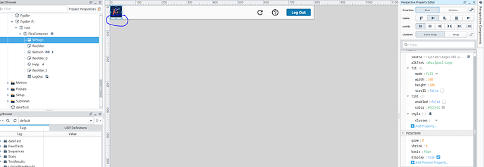

**Author:** ![mal](https://avatars.discourse-cdn.com/v4/letter/m/a698b9/32.png) [@mal](https://forum.inductiveautomation.com/u/mal)\
**Post date:** [January 19, 2022, 7:26pm UTC](https://forum.inductiveautomation.com/t/bug-2280-images-uploaded-to-perspective-have-whitespace-added-to-the-bottom-when-using-flex-containers/55173/3 "2022-01-19T19:26:54Z")
Here is what we get, you can see the image box is larger than the image itself. I have tried a dozen different manipulations to see if I can get rid of it.
 ![image](https://us1.discourse-cdn.com/inductiveautomation/original/3X/c/a/ca47f16f58c7eb9e8d0ba90a09aec7ff125ab451.png)
It appears to be artificially adding a few pixels to the image box for any setting other than the flex “items” stretch option, which isn’t preferred for our other components.

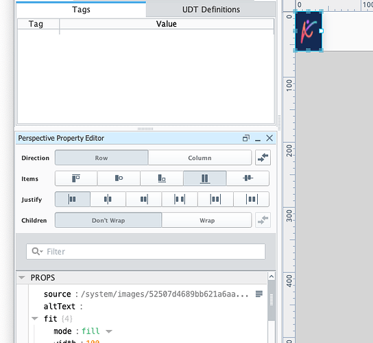

**Post date:** [January 19, 2022, 7:32pm UTC](https://forum.inductiveautomation.com/t/bug-2280-images-uploaded-to-perspective-have-whitespace-added-to-the-bottom-when-using-flex-containers/55173/4 "2022-01-19T19:32:12Z")
Another example with a close-up on the image block, you can see the added pixels at the bottom of the image block (note this was taken from different view).
![image](https://us1.discourse-cdn.com/inductiveautomation/original/3X/0/4/04ab3032648e2c900d53481a548d269e66c60f6d.png)
**Author:** ![cmallonee](https://sea1.discourse-cdn.com/inductiveautomation/user_avatar/forum.inductiveautomation.com/cmallonee/32/6416_2.png) [@cmallonee](https://forum.inductiveautomation.com/u/cmallonee)\
**Post date:** [January 19, 2022, 9:09pm UTC](https://forum.inductiveautomation.com/t/bug-2280-images-uploaded-to-perspective-have-whitespace-added-to-the-bottom-when-using-flex-containers/55173/5 "2022-01-19T21:09:38Z")
Could you supply the image file in question? If you can’t share it on the forum, could you send it to me as a Direct Message? I’m not seeing the behavior your photos show, and so I’m inclined to believe that white space is part of the image file.

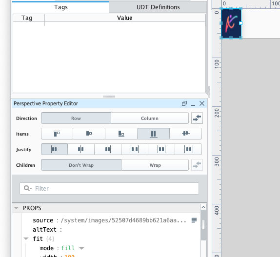

**Post date:** [January 19, 2022, 10:07pm UTC](https://forum.inductiveautomation.com/t/bug-2280-images-uploaded-to-perspective-have-whitespace-added-to-the-bottom-when-using-flex-containers/55173/7 "2022-01-19T22:07:15Z")
![Screen Shot 2022-01-19 at 2.03.11 PM](https://us1.discourse-cdn.com/inductiveautomation/original/3X/2/1/213d0b036d5877feec7f7a282eeb21ed8448d1a8.png)
I see the image stretch to fill available space when using the “fill” setting.
**Post date:** [January 19, 2022, 10:18pm UTC](https://forum.inductiveautomation.com/t/bug-2280-images-uploaded-to-perspective-have-whitespace-added-to-the-bottom-when-using-flex-containers/55173/8 "2022-01-19T22:18:41Z")
Change your flex container items setting to any of the other options.
**Post date:** [January 19, 2022, 10:30pm UTC](https://forum.inductiveautomation.com/t/bug-2280-images-uploaded-to-perspective-have-whitespace-added-to-the-bottom-when-using-flex-containers/55173/9 "2022-01-19T22:30:49Z")
Ah, okay. That is an open issue where multiple components do not behave correctly when not using stretch. It’s a result of them not having any content which sets its own dimensions. Since an image has no defined dimensions it can’t figure out how to size itself.
