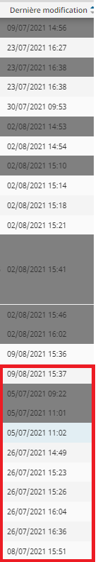

**Author:** ![nicolas.griffon](https://sea1.discourse-cdn.com/inductiveautomation/user_avatar/forum.inductiveautomation.com/nicolas.griffon/32/16603_2.png) [@nicolas.griffon](https://forum.inductiveautomation.com/u/nicolas.griffon)\
**Post date:** [August 11, 2021, 2:00pm UTC](https://forum.inductiveautomation.com/t/bug-2737-perspective-table-sorting-date-column/31213/16 "2021-08-11T14:00:58Z")
I’m unable to understand the date sorting in 8.1.7
I’ve tried
- Remove order by in my named query
- Change render on my table’s column to auto or date
and it’s same false result
The date format is “DD/MM/YYYY HH:mm” because of French users
 ![bug-2737](https://us1.discourse-cdn.com/inductiveautomation/original/3X/4/e/4e3944ef154d651651c1946f2fded9a1d852ab29.png)
strangely, on some views with the same column configuration sorting on dates values seems to work.
I have an example with rows from the audit\_logs SQL table that sorts correctly into the perspective table.
**Post date:** [September 23, 2021, 9:41am UTC](https://forum.inductiveautomation.com/t/bug-2737-perspective-table-sorting-date-column/31213/18 "2021-09-23T09:41:35Z")
I’ve just installed the 8.1.10 version and it seems to be corrected.
I can’t reproduce this sorting issue in my views with my data.
Good job!
