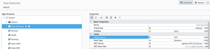

As in the title.
Example:
UDT definition
 ![image](https://us1.discourse-cdn.com/inductiveautomation/original/3X/3/a/3a0bfd155a5afb4be9b776abf0ec9e5fa913e95f.png)
UDT definition tags
 ![image](https://us1.discourse-cdn.com/inductiveautomation/original/3X/8/b/8b5c4605123a00b556c9e8171d85a033249ccf74.png)
UDT instance
 ![image](https://us1.discourse-cdn.com/inductiveautomation/original/3X/3/5/357e3bb67997aecee8b0257cd3890c13efb7b60d.png)
UDT instance overrides on tag ‘Flow Detected’
 ![image](https://us1.discourse-cdn.com/inductiveautomation/original/3X/c/3/c304e1ab68537e7e9ecef0071806d57fe0cb58a6.png)
Delete UDT definition ‘Pump’ then re-import it back in.
UDT instance overrides now missing!
 ![image](https://us1.discourse-cdn.com/inductiveautomation/original/3X/7/4/74d444afbd910e8d263c690e4b5c805a7ba483e6.png)
This issue has stumped me for a while, but I finally worked out how to produce it. Very annoying, as this basically stops me from using Json copy and paste, as using this method merges tag changes instead of overwriting them, meaning deleted tags in the import remain there…

My apologies. I made a mistake here. Instead of overriding a UDT instance's property, I was 'overriding' (changing the opc item path in the definition locally) the definition of the UDT which will get overwritten when pushed from EAM. I believe that is the correct functionality for this. I did just test the overrides on the individual instances and those seem to persist when I push updates to the UDT definition.
I believe I can work around the specific issue I was having now that I see what I was doing wrong.
