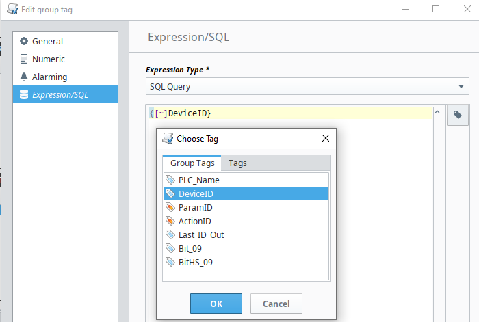

Hi, I'm using Ignition 8.1 RC1.
I'm trying to create a transaction group that will write to the DB based on a trigger from the PLC. I can't find a way to use group tags in named queries, it will only allow tags from the tag provider (Image 1). But if I were to use the "SQL Query" option instead (Image 2), it will let me use the group tags. See picture below.
**Image 1**
 ![image](https://us1.discourse-cdn.com/inductiveautomation/original/3X/5/9/5918ab33c173238c88f4223f812f3f0377e84872.png)
**Image 2**
 ![image](https://us1.discourse-cdn.com/inductiveautomation/original/3X/e/c/ecbfc6aead5b911949e369cc11c103abcf36e60a.png)
Is it a bug or is it a design limitation?
I mean, there's a workaround, I can create a stored procedure in the DB but I'd rather use a built-in feature that is intended for this.

I would classify this as a bug - and have filed it as such.

**Post date:** [April 27, 2022, 3:27pm UTC](https://forum.inductiveautomation.com/t/bug-831-unable-to-use-group-tags-in-named-queries-transaction-groups/39466/5 "2022-04-27T15:27:36Z")
It’s still a bug, just hasn’t been picked up yet to be fixed.
There’s nothing _preventing_ you from doing it, as I understand it - the UI just doesn’t make it easy for you. You should be able to pass `{[~]NameOfGroupTag}` as a parameter binding.
