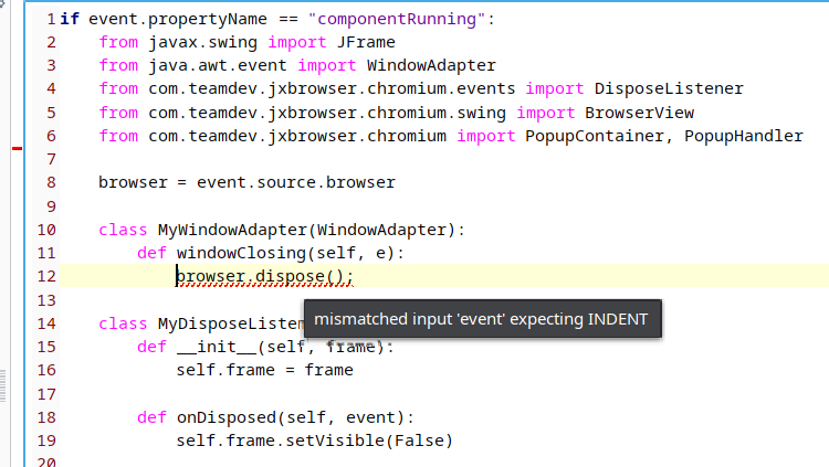

I use Ignition v.8.0.11
**Post date:** [May 5, 2020, 5:02pm UTC](https://forum.inductiveautomation.com/t/bug-975-vision-web-browser-popup/34297/7 "2020-05-05T17:02:44Z")
Okay, so you don’t have the `initialize` hook, which makes this slightly harder, but you can still run the same code. In `propertyChange`, put all the code behind an `if event.propertyName == "componentRunning":`, then change the `browser` on the last line to `event.source.browser`.
**Author:** ![iscrac](https://sea1.discourse-cdn.com/inductiveautomation/user_avatar/forum.inductiveautomation.com/iscrac/32/49757_2.png) [@iscrac](https://forum.inductiveautomation.com/u/iscrac)\
**Post date:** [May 5, 2020, 5:07pm UTC](https://forum.inductiveautomation.com/t/bug-975-vision-web-browser-popup/34297/8 "2020-05-05T17:07:45Z")
> [@paul-griffith](#):
 ![image](https://us1.discourse-cdn.com/inductiveautomation/original/2X/d/d37a45f00c28b669631f586b9869a2318da39b4a.png)
**Post date:** [May 5, 2020, 5:09pm UTC](https://forum.inductiveautomation.com/t/bug-975-vision-web-browser-popup/34297/9 "2020-05-05T17:09:10Z")
Try removing the semi-colon–that’s a left-over from java syntax.
**Post date:** [May 5, 2020, 5:10pm UTC](https://forum.inductiveautomation.com/t/bug-975-vision-web-browser-popup/34297/10 "2020-05-05T17:10:21Z")
it didn’t help((
**Post date:** [May 5, 2020, 5:11pm UTC](https://forum.inductiveautomation.com/t/bug-975-vision-web-browser-popup/34297/11 "2020-05-05T17:11:16Z")
Double check that you aren’t mixing tabs and spaces in your indentation.
**Post date:** [May 5, 2020, 5:13pm UTC](https://forum.inductiveautomation.com/t/bug-975-vision-web-browser-popup/34297/12 "2020-05-05T17:13:39Z")
THanx!! the problem is in spaces) thanx so much)

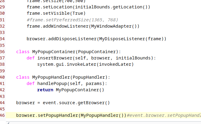

**Author:** ![Matthew.gaitan](https://avatars.discourse-cdn.com/v4/letter/m/59ef9b/32.png) [@Matthew.gaitan](https://forum.inductiveautomation.com/u/Matthew.gaitan)\
**Post date:** [May 5, 2020, 6:23pm UTC](https://forum.inductiveautomation.com/t/bug-975-vision-web-browser-popup/34297/17 "2020-05-05T18:23:02Z")
can you post your complete code from property change?
**Post date:** [May 5, 2020, 7:29pm UTC](https://forum.inductiveautomation.com/t/bug-975-vision-web-browser-popup/34297/18 "2020-05-05T19:29:27Z")
```auto
if event.propertyName == 'componentRunning':
	from javax.swing import JFrame
	from java.awt.event import WindowAdapter
	import java.awt.Dimension
	from com.teamdev.jxbrowser.chromium.events import DisposeListener
	from com.teamdev.jxbrowser.chromium.swing import BrowserView
	from com.teamdev.jxbrowser.chromium import PopupContainer, PopupHandler
	class MyWindowAdapter(WindowAdapter):
   		def windowClosing(self, e):
			browser.dispose()
	class MyDisposeListener(DisposeListener):
		def __init__ (self, frame):
			self.frame = frame
		def onDisposed(self, event):
			self.frame.setVisible(False)
	def invokedLater():
		BrowserView.browserView = BrowserView(event.source.browser)
		browserView.setPreferredSize(initialBounds.getSize())
		frame = JFrame("Popup")
		frame.setDefaultCloseOperation(WindowConstants.DISPOSE_ON_CLOSE)
		frame.add(browserView, BorderLayout.CENTER)
		frame.pack()
		frame.setLocation(initialBounds.getLocation())
		frame.setVisible(True)
		#frame.setSize(700,500)
		#frame.setPreferredSize(1365, 768)
		frame.addWindowListener(MyWindowAdapter())
		browser.addDisposeListener(MyDisposeListener(frame))
	class MyPopupContainer(PopupContainer):
		def insertBrowser(self, browser, initialBounds):
			system.gui.invokeLater(invokedLater)
	class MyPopupHandler(PopupHandler):
		def handlePopup(self, params):
			return MyPopupContainer()
	event.source.browser.setPopupHandler(MyPopupHandler())
**Post date:** [May 5, 2020, 8:23pm UTC](https://forum.inductiveautomation.com/t/bug-975-vision-web-browser-popup/34297/19 "2020-05-05T20:23:29Z")
from what I can tell, to get an instance of the browser you have to call:
```auto
browser = event.source.getBrowser()
so in your case you’d have to add the line above and change the last line to:
```auto
Hopefully this helps
**Post date:** [May 5, 2020, 8:31pm UTC](https://forum.inductiveautomation.com/t/bug-975-vision-web-browser-popup/34297/20 "2020-05-05T20:31:07Z")
> [@Matthew.gaitan](#):
like that?:
 ![image](https://us1.discourse-cdn.com/inductiveautomation/original/2X/c/c059b813bafa1d34cb1d60cb906424f9b0508980.png)
doesn't work... oh gosh...
