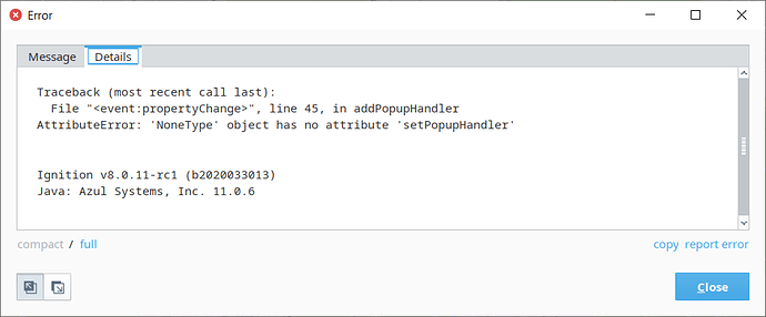

move the code from line 44 up to right after your includes (but leave line 46 where it’s at)
line 34 (as well as one of the lines above that which reference browser) might be failing due to those also needing browser to be defined.
if it still fails after that, what error is displayed?
**Author:** ![iscrac](https://sea1.discourse-cdn.com/inductiveautomation/user_avatar/forum.inductiveautomation.com/iscrac/32/49757_2.png) [@iscrac](https://forum.inductiveautomation.com/u/iscrac)\
**Post date:** [May 5, 2020, 8:43pm UTC](https://forum.inductiveautomation.com/t/bug-975-vision-web-browser-popup/34297/22 "2020-05-05T20:43:06Z")
> [@Matthew.gaitan](#):
this error:
 ![image](https://us1.discourse-cdn.com/inductiveautomation/original/2X/b/b93347a7c0644636417c55acb98a3267645ec434.png)
**Author:** ![Matthew.gaitan](https://avatars.discourse-cdn.com/v4/letter/m/59ef9b/32.png) [@Matthew.gaitan](https://forum.inductiveautomation.com/u/Matthew.gaitan)\
**Post date:** [May 5, 2020, 8:49pm UTC](https://forum.inductiveautomation.com/t/bug-975-vision-web-browser-popup/34297/23 "2020-05-05T20:49:29Z")
right after you assign the browser variable to event.source.getBrowser()
do an:
```auto
if browser:
and tab the rest of your code over.
**Post date:** [May 5, 2020, 8:53pm UTC](https://forum.inductiveautomation.com/t/bug-975-vision-web-browser-popup/34297/24 "2020-05-05T20:53:13Z")
The propertyChange event is firing before the browser component has loaded; it’s loaded async because it’s such a heavyweight object. You’ll probably have to use `invokeLater`; there’s no property change event to hook into that will fire once the browser is ready.

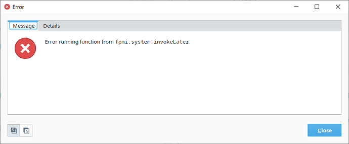

**Post date:** [May 5, 2020, 9:17pm UTC](https://forum.inductiveautomation.com/t/bug-975-vision-web-browser-popup/34297/27 "2020-05-05T21:17:24Z")
Thanx!
but see what error I get:
 ![image](https://us1.discourse-cdn.com/inductiveautomation/original/2X/e/e0362a3677777e7e6e7412230cad23af6e39237f.png)
 ![image](https://us1.discourse-cdn.com/inductiveautomation/original/2X/f/ff0631906b87d0bef57848e1647ed993669b1a40.png)
**Post date:** [May 5, 2020, 9:18pm UTC](https://forum.inductiveautomation.com/t/bug-975-vision-web-browser-popup/34297/28 "2020-05-05T21:18:07Z")
Try making the 5,000 some larger value, like 30,000; it’s just an arbitrary threshold to give your client time to load the web browser component.
