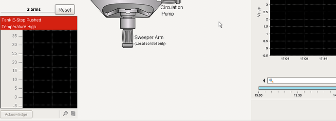

I’m having an issue with the Alarm Status Table where it’s showing the alarms present, but in the other blank area it’s showing a screenshot of another area of the page within it… The screenshot below shows this, where the top two alarms are shown, and the area of the Alarm Status Table below it is showing part of the chart object that is displayed on the page to its right. The developer is unaffected, this is only happening in the client.
 ![](https://us1.discourse-cdn.com/inductiveautomation/original/2X/1/12e340aaa8ec1d64c338630be71552cd240202d5.png)
Any ideas?
Cheers

The only time I’ve seen this sort of screen “damage”, it was a graphics driver flaw in the OS, not Ignition.

Thanks Phil. However it looks like this might be a bug, as when I turn on showing of the Table Header it goes away
